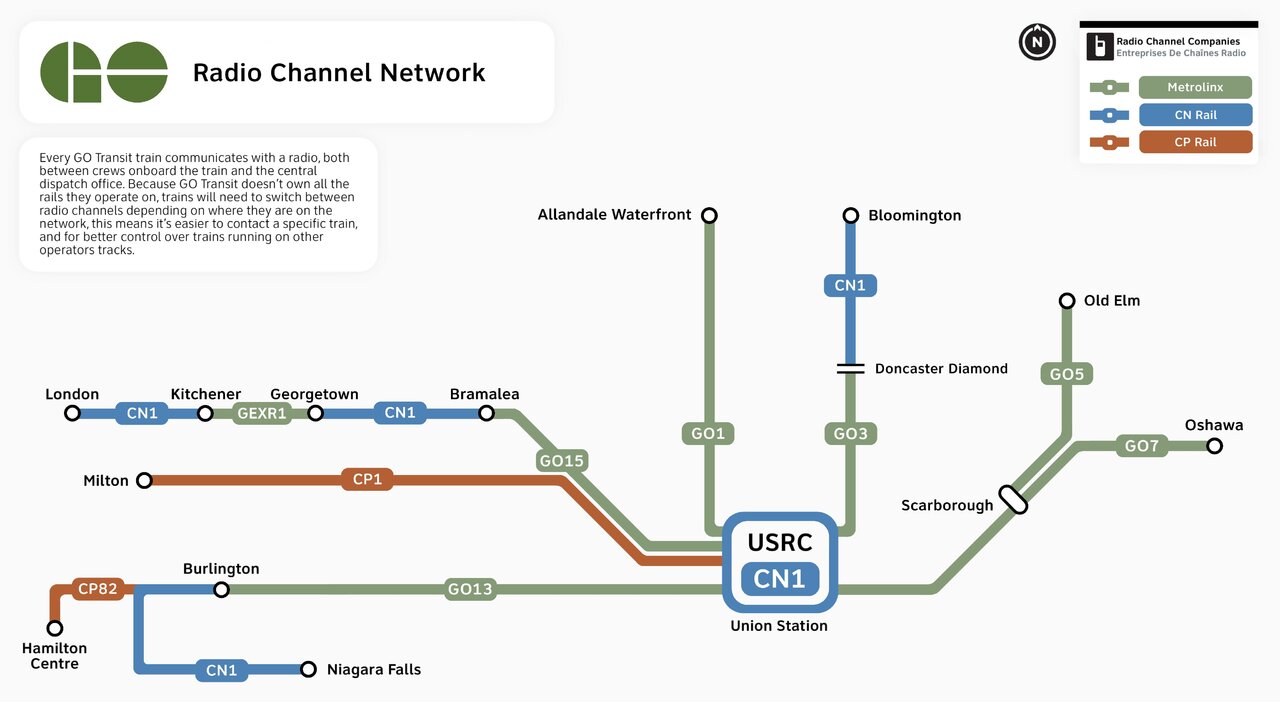

Is there any reason why GO never renamed GEXR1 to fit the standard radio channel names seen elsewhere on the GO network? They renamed other channels when they bought the tracks, so why didn’t they do the same for GEXR1?

GO has moved off the old AAR frequencies (which CN and CPKC still use) to the newer NXDN radio technology which has new frequencies as well as a digital transmission mode. The freight railways are supposed to follow suit, but it is a bigger network transition for them, and they are in no hurry.
I'm surprised to see USRC on CN1 (ARR 8787) - for a long time they were on ARR 1010. Perhaps that makes things easier for VIA.
Before the change, the airwaves were getting horribly congested especially on CN 1 because of all the Rule 42's... at rush hour there could be a huge number of GO trains talking all over each other trying to get permission from track foremen to pass through all the Rule 42 work limits. To my ear, the situation was downright unsafe because the airwaves never stopped talking. With the new GO setup, that problem has been eliminated.
The Guelph Sub is still dispatched by a contractor and I assume that it may be technically difficult (or costly) to transition the base towers for that radio system over to the GO network. With both GEXR and CN in the mix, any change would be complicated. The current setup out there works well, so if it ain't broke.....
Is there any way why GO never renamed GEXR1 to fit the standard radio channel names seen elsewhere on the GO network? They renamed other channels when they bought the tracks, so why didn’t they do the same for GEXR1?View attachment 492974
That part of the Guelph sub is still dispatched by RailTerm. Presumably whenever that contract ends and MX takes over the dispatching they'll switch the radio channels over.

Is there any reason why GO never renamed GEXR1 to fit the standard radio channel names seen elsewhere on the GO network? They renamed other channels when they bought the tracks, so why didn’t they do the same for GEXR1?View attachment 492974
That section is under Railterm RTC still even though it's owned by Metrolinx... the other sections with GO Channels are done by Metrolinx RTC
One further factoid - Railterm is now a subsidiary of Siemens, and handles the RTC function for numerous short lines in Canada.
