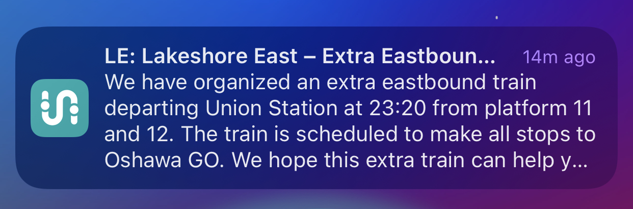

I haven’t seen an extra train scheduled in a while:
There's often extra trains on evenings and weekends after major events (Skydome, BMO Field, ScotiaBankSomething, CNE, etc.). There was a lot earlier this year, though they have diminished in recent weeks with the crew shortages.
I'm not sure what this one was about - it seems to have originated at Union rather than Exhibition. Was there another event on downtown this evening? Neither Jays nor TFC were playing.
Yeah I know, I was pointing it out because I haven’t seen once since the crew shortages started, hopefully that means the situation is getting better.
I don't know if it's getting better, but with the huge cut to scheduled Lakeshore service (going from every 15 minutes to every 30 minutes mid-day), then there's surely now more crews for extra and fill-in runs.
