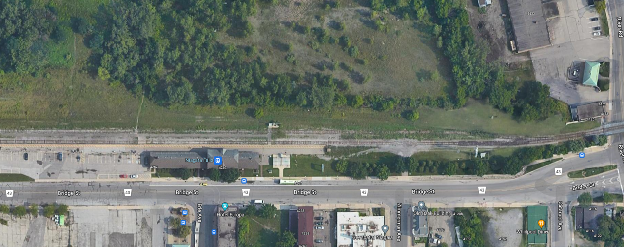

Crazy Niagara train ride today, as we were rounding the curve on the final approach to Niagara they had to stop as a late Amtrak Maple Leaf was still doing customs, and a 6 car Maple Leaf and 14 car GO train (locomotives included) can’t fit on the same platform.
The length of the trains is besides the point - you had a westbound train east of an eastbound train on a single track! Clearly nobody's going anywhere in that situation.
Since the Maple Leaf is crewed by VIA could they not warn the GO train that they are occupying the station track? It would be a courtesy.
It's not about courtesy. It's about recognizing information that needs to be passed to others so everyone does their job effectively and safely. That's an obligation, not being polite.
I have to assume that the Maple Leaf crew was likely not aware that another train was in the area, until it arrived.
There are two schools of thought about whether RTC's should give heads-ups to crews. One is that it creates a mental conflict that tempts the crew to make assumptions or disregard other information (an example being when a signal indication or field condition changes, and differs from what the RTC told them) - plus, it may overload the crew with information they don't really need. The other is that it arms the crew with information that they might use constructively.
In this case, if someone somewhere had said, "Hey, isn't the Maple Leaf running again?" someone else might have said "Ummmm....."
But IMHO far better if the RTC had attempted to line the GO train into the platform and it was a buzzer and a panel light that said, "Ummm....."
PS - the RTC who was controlling the GO train was likely located in Edmonton. The RTC who was controlling the approaching Maple Leaf up to the border was likely in Jacksonville Florida. What could go wrong?
PPPS - removing the derail is not an option so long as the territory remains as is. It is a safety feature that has to be there by design, as under past/current operations that siding may be used to store cars or equipment. However, providing the proper keys so crews can operate it might be another possibility.
That someone went and put a special lock on the derail without something else that ought to prevent use is honestly the wildest part of this thing. It really SHOULD just be on a switch lock.
As far as amount of dark territory, don't forget that the entire north mainline was dark until Metrolinx got involved. Without the PTC mandate the class 1s really aren't shy about doing this way.
Who else would use that siding? You think CN would store cars on the station siding? Wouldn't they need permission?
There is no second platform there so even if they could use the second track they would need to backup again and then enter the station track after the Maple Leaf left.
Why would CN need permission to store cars on the track it owns? This is CN trackage, not ML trackage.
They certainly wouldn't store cars in the mainline, or a regularly used siding, but this is not that.
They would store cars in a station sliding?
Well, that's what a siding is for. As noted, this siding is likely there for that purpose, and not as a passing point.
One might use it if, say, there were a VIA or GO train that lays over for the evening at Niagara Falls.
And then, railways are famous for taking extreme measures after the horses have left the barn
Changes made after runaway rail car crossed border
Yeah but if either the trains were shorter or the platform was longer, GO could’ve unloaded, reloaded, and went back to Toronto in just over 10 minutes, instead of a 40 minute delay trying to find keys and finding a siding for GO to reverse back to.
