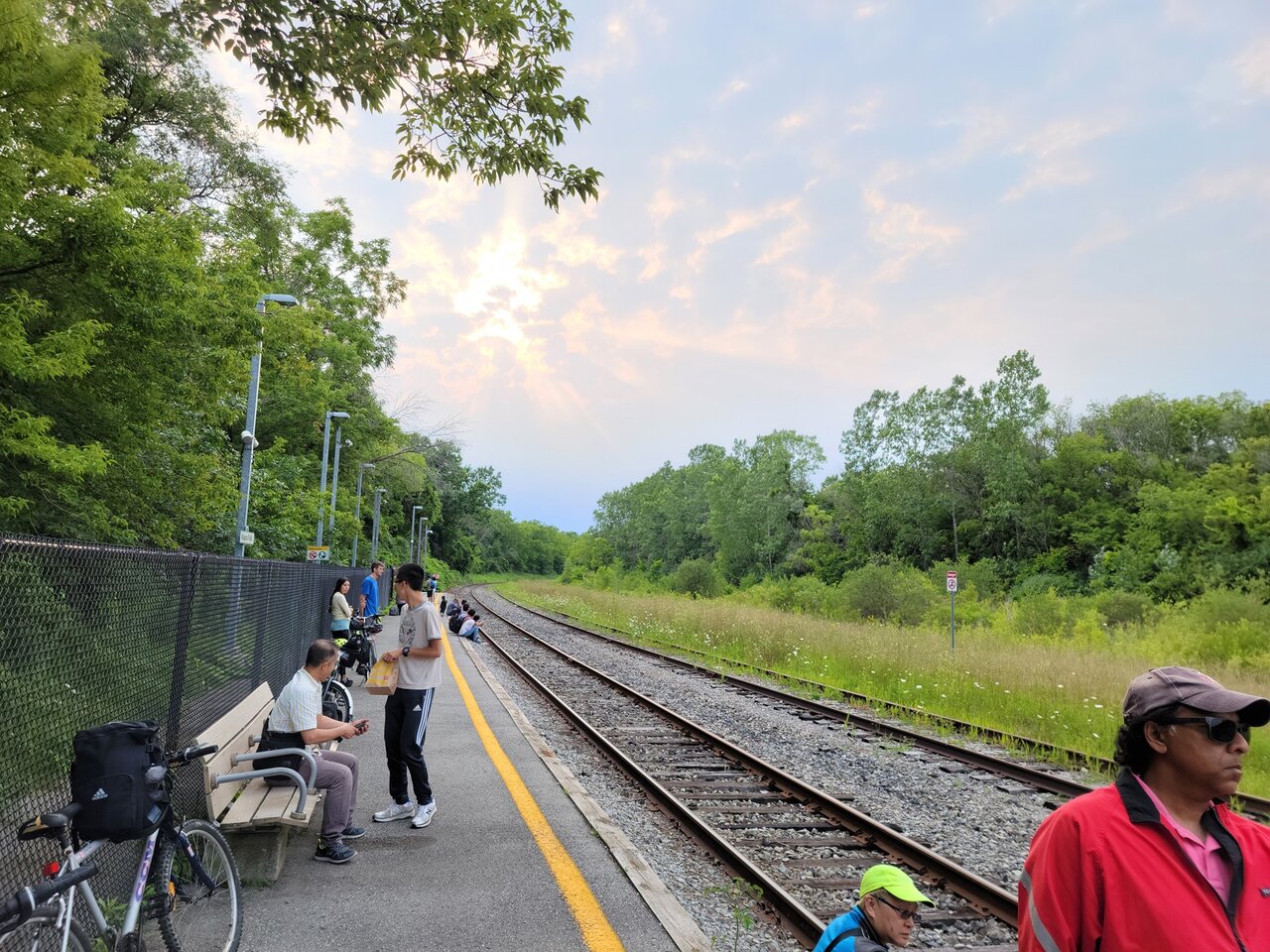

EDIT: Looks like the station area does actually have a second track but it's very overgrown and doesn't have platform that passengers could use. I guess with some refurb and money Metrolinx could make your idea happen...but this is Metrolinx we're talking about so no way they spend a penny on the Niagara station.
There is a second track but you are right it is heavily overgrown. No doubt it is safe to use but it is not suitable for passenger use, it is more of a siding.

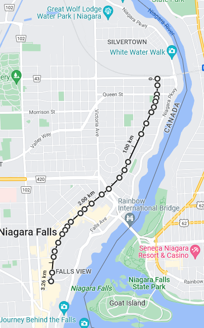

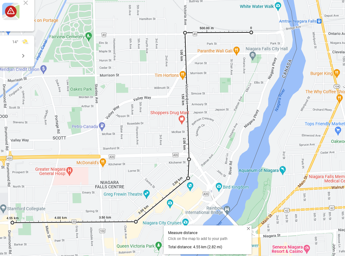

The old ROW is partially a bike path, and partially runs through people's back yards and even on-street; reactivating that is unlikely.
As I see it there are two practical options, though both are expensive and will take years to deliver.
1) Build an LRT on-street from the existing Niagara Station likely down Victoria
This is the more likely scenario in my opinion, but not one that is remotely imminent.

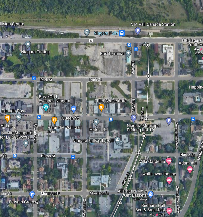

The other is to have the Niagara service approach from the opposite end, following the old TH&B corridor (still active CP mainline) from Hamilton through to Welland and then down the spur leading into Niagara Falls.
That spur dead ends at the Casino which was literally built on the ROW.
While this makes a lot of sense in many ways, it also means a route that does not serve St. Kitts or wine-country and that doesn't have any major population centres other than Welland en route from Hamilton.
The spur is also in terrible condition and would have to be completely rebuilt.

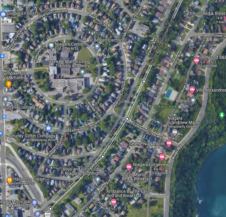

I've drawn the above image back to almost the Welland Canal, but that track (which has the advantage of going under the canal) extends all the way back to Hamilton.
I've only added a couple hundred metres of track in Niagara otherwise using active corridor only, and it ends pretty close to The Falls itself. The option though certainly exists to reinstate the corridor further along at least to the Casino; getting past f
Fallsviews w/o reconstructing same may be a bit too much to ask.
You can see that here w/the full aerial image, the white line being the track I have drawn in above:
Edit to add: This is the old ROW from NF station:
A few aerials to give you a sense of it:
