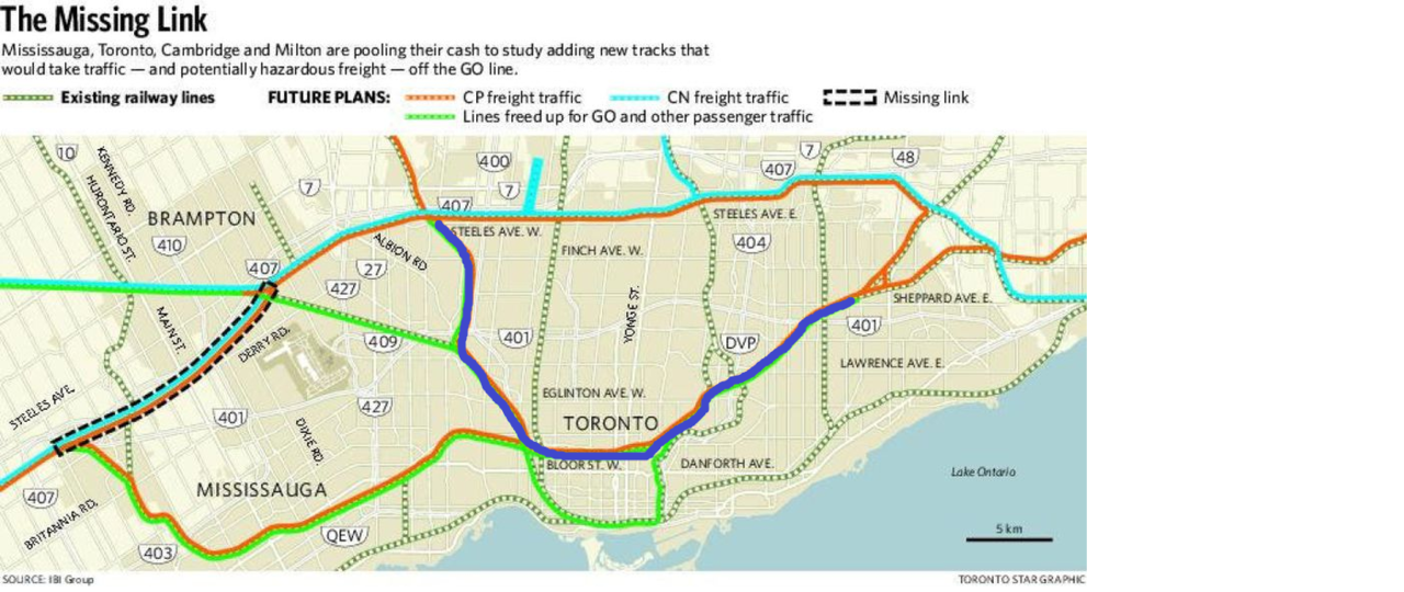

I actually envisioned a "SmartTrack 2.0" (ok lets call it GO RER 2.0... it was a while ago!) after the Missing Link was implemented (dark blue on map)
As the section you discussed and the Midtown GO line would both be freed up by it, and a "subway like" service would be possible.

The last GO Woodbridge/Bolton study I saw had the line routed North on the Newmarket line, West on the CN Halton sub and then back North on the CP Macteir sub that runs through Woodbridge/Bolton. Rather than the more logical GTS/Weston sub connection to CP Macteir.
I think this is absurd since it misses obvious opportunities for stations at Sheppard W (Possible connection to a Sheppard W LRT/BRT) and Finch W (Connection to Finch LRT) and even a commuter station near the 401. And the North West of Toronto is relatively underserved by transit to begin with.
I know the GTS/Weston corridor is quite busy but it's also the widest ROW in the region and I don't see why a 4 (or maybe 5) track ROW couldn't accommodate Via, UPX, GO Kitchener, CP and a GO Bolton service.
Even if the Missing Link and Midtown corridor doesn't come to fruition, I feel like this would still be a very worthwhile service.
Weston, Mt. Dennis, Stockyards, Bloor West, Liberty Village/Queen, Bathurst-Spadina would hit a lot of trip generators/destinations/transfer connections before eventually reaching Union Station.
Which can be fed by feeder buses and mixed-use intensification along the Bolton corridor at the locations I mentioned in the previous post (Wilson, Sheppard, Finch, maybe Steeles), along with Woodbridge and a suburban catchment station (or two?) at Elder Mills/Kleinberg/Nashville.
The 2010 study looked at routing via CN south of the Halton Sub as an alternative. For the reasons you suggest, it didn't rank favourably. But that's what studies do, consider options.
The only issue with a connection to the Kitchener line somewhere around Weston - Mount Dennis is, there would have to be be crossover movements as trains enter/exit the Kitchener line. This is an added complexity that could affect both express and local services. Not saying it isn't possible, but we don't know how GO intends to run things once the fourth track is built.
If the operating plan would require Bolton trains to cross over in front of express or even local trains, it's a problem, even though the 4-track line has loads of capacity. Crossover movements are the bane of high capacity multi track operations.

The advantage to what I posted is that it never touches the Kitchener Line. There are separate CP tracks that connect from the route to Montreal through midtown to the route that goes to Bolton, that have nothing to do with the existing Metrolinx tracks.
The service would dump people off into Dupont subway station who want to continue downtown.
