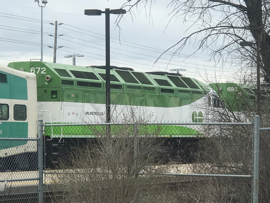

After going through some photos I took last week, I noticed that GO 602 (one of the oldest MP40s) now has the same roof-mounted particulate filter that 657-666 were delivered with. Does anyone know if this was just a one off conversion, or is GO planning to retrofit other units?
