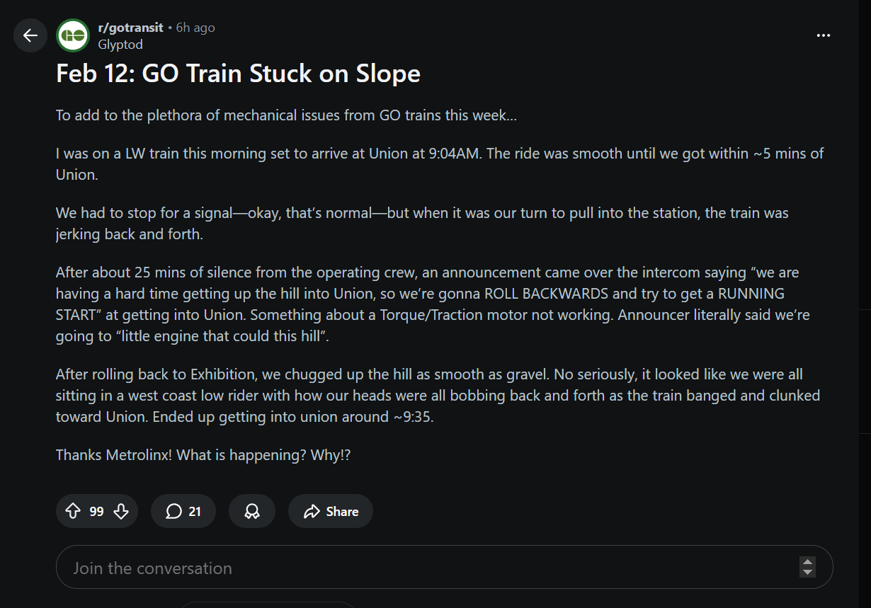

Interesting situation earlier today with one of the locomotives entering Union Station. Some people speculating the traction motor gave out?
Anyone with insider knowledge, on a scale of 1 to 10, how would you rate the current state of GO's locomotive fleet?
Could be a traction motor.
But it could also be that the track was slippery. And with a grade in excess of 2% in the flyunder, a fully-laden 12-car train can get caught stuck if there is poor rail.
The dynamics of the way the train is oriented makes a difference, too. If the loco is pushing, all of the cars in front of it clean the railhead so that the loco can maximize its traction. With the loco pulling the leading axle of the loco has to do all of the cleaning for the trailing wheels, meaning that it may only be providing a fraction of the force that it would otherwise be.

The comment that the second attempt was very jerky makes me think the wheelslip circuity and/or sanders might have been misbehaving as well. At the very least, loss of adhesion would be reducing power to the wheels, potentially overriding the throttle input..
