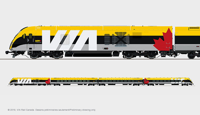

This thread is for GO's fleet, but VIA's awarding of a fleet contract to Siemens should be mentioned, especially given the great platform height debate. 32 new bi-directional trainsets, powered by Charger locos. Not too many details on the coaches, but they look to be high floor.

They are high floor - 51" off of the top of rail - but will include traps and steps for low-level platforms.
