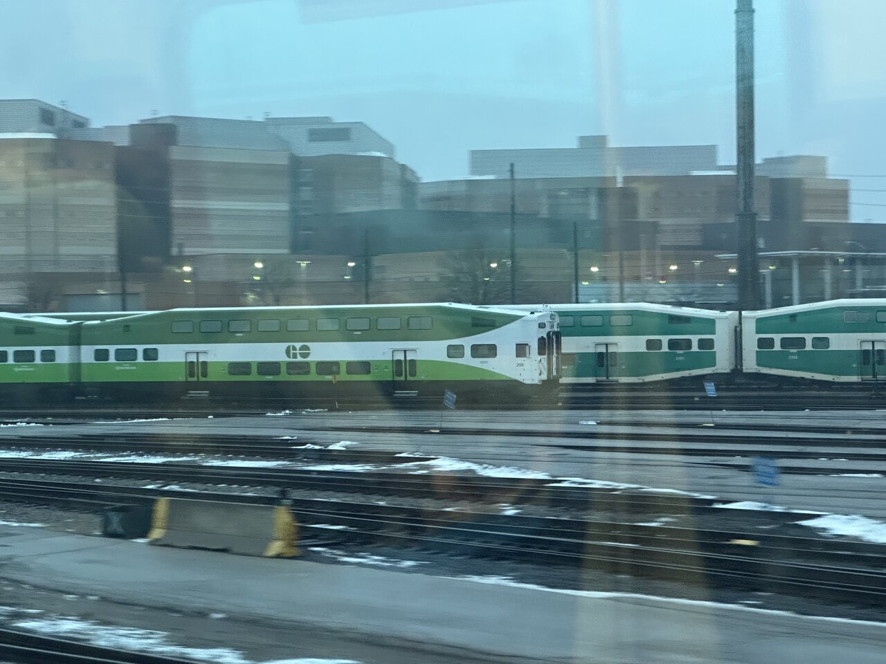

I’m guessing this is going to be a new procedure? Using the old cab cars as mid set coaches on 10 car weekdays trips and then splitting off the consists to become 6 car consists with them leading on weekends?
