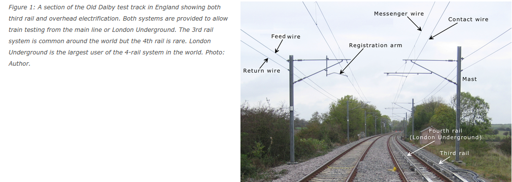

Modern cat looks nothing like that, or at least doesn't need to:
Here's two variations of the newer designs (there's even a more elegant one that's not only visually less apparent, but higher functioning too that I'll link when I can find a pic)
http://www.railway-technical.com/infrastructure/electric-traction-power.html

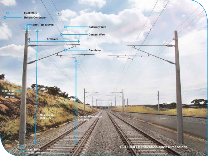

Before someone points out that is 1500 VDC (and thus smaller insulators, albeit heavier contact wire), here's the Adelaide cat, installed just a few years ago, and 25 kVAC, the de-facto int'l standard and what GO keeps referring to in their "Theory of Electrification":
https://www.dpti.sa.gov.au/__data/a...0/Electrification_singlepages_new_Low_Res.pdf
The pdf details different catenary types and the visual factor.
