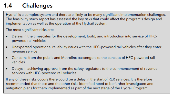

From the equivocating Metrolinx Report on Hydrail: (Politically driven, the best the QP Overlords got from Metrolinx' public position was 'about even, but wait and see')(Their jobs were on the line unless they did as they were told. many stating "madness" on it, one board member actually stated it publicly)
Metrolinx board member described hydrogen train plan as 'madness'
Implementing a Hydrail System on the GO network will require major challenges to be overcome. These include:  The potential for the longer-than-planned development timescales for HFC-powered rail vehicles so that Metrolinx is unable to meet the target of 2025 for the commencement of RER services. Metrolinx has already started mitigate this risk through the process of developing both an HFC-powered locomotive and EMU. By commissioning rail vehicle manufacturers to prepare conceptual designs for both types of vehicles Metrolinx will be able to validate the principles of how an HFC-powered rail vehicle will perform. Beyond this concept design work, the risks of time over-runs during design, build, and testing of rail vehicles would be managed by an appointed rail vehicle manufacturer. Based on the experience of Alstom, which took 3 years to develop and bring into testing their Coradia iLint HFC-powered EMU, it seems feasible to expect a rail vehicle manufacture to complete the development and build of HFC-powered trains in the time available to commence RER services in 2025. Furthermore, Metrolinx would expect to procure an HFC-powered rail vehicle fleet on the basis that the supplier will be responsible for any risks to achieving the specified RER reliability and availability targets.  HFC locomotives and EMUs of the type needed for RER do not yet exist; therefore, real-world experience relating to reliability is limited to the operation of light rail vehicles and buses. This means that even though the vehicles will go through an extensive development and testing process, there is still a risk that when they enter revenue service, they will experience unexpected issues with reliability that cause in-service failures and consequential impacts to customers.
This risk also applies to the hydrogen production, storage, refuelling, and dispensing facilities; and it is probable that the greatest risk relates to the integration of these systems. However, this risk can be mitigated by implementing and operating a small-scale prototype of the end-to-end system so that lessons can be learned about the system’s operation, performance, and reliability; and so these lessons can be fed back into the design, build, and operation of the full system.  Difficulties in gaining the public’s and Metrolinx passengers’ acceptance of the concept of the Hydrail System. There are many myths and misunderstandings about the safety of hydrogen, which, if not addressed, could lead to resistance to the implementation of a Hydrail System. These would need to be addressed through a comprehensive public communication strategy that provides a considered perspective on safety and the resulting environmental benefits of using hydrogen. The experience of the German government’s public communications strategy in relation to hydrogen indicates that if a similar approach is adopted by Metrolinx, the likelihood that this could become a major challenge would be reduced.  Achieving the approval of relevant safety regulators, including Transport Canada and TSSA, would be a key objective of developing the Hydrail System and bringing it into service. This challenge should not pose a significant risk as codes and standards already exist for all the components that will be used in the Hydrail System. An important consideration for Hydrail is in the regulations that would govern the overall safety management of the Hydrail vehicles in scenarios where there has been an accident or a component failure.It is expected that the safety risk in this situation would be acceptable because of several factors:  Safety in design would be a key objective during the Hydrail System design phase  Metrolinx will assemble a team of world leading experts in all aspects of hydrogen and railway safety to provide it, and the rail vehicle manufacturer, with necessary advice on design safety and regulation development.  Metrolinx will work closely with Transport Canada and TSSA through the design, build, and testing process to understand what rules and regulations need to be developed specifically to cover the Hydrail System. HYDRAIL FEASIBILITY STUDY REPORT CPG-PGM-RPT-245 19 Revision B DATE: 02/02/2018 1.5 Opportuniti
http://www.metrolinx.com/en/news/an...G-PGM-RPT-245_HydrailFeasibilityReport_R1.pdf
Not exactly what some posters would have you think.
