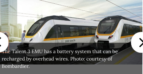

^ What the Hydrail propagandists don't tell you is that battery-powered EMUs are being considered as much or more than Hydrail in Europe:
Bombardier revives the battery-powered train
It's the first first of its kind to operate in Europe in over 60 years.
Steve Dent
, @stevetdent
09.17.18 in Transportation
dims
Bombardier
Diesel trains are noisy and polluting, but on stretches of non-electrified rail, what else are you going to do? Hydrogen trains are one option, but now there's another: Canadian transportation firm Bombardier has (re-)introduced the battery powered train. In Berlin, it launched the Bombardier Talent 3 electro-hybrid train, the first of its kind in Europe in over 60 years, the company said. The train took its maiden voyage with local luminaries including the federal commissioner for rail transport and the Brandenburg transport minister.
"Around 40 percent of the German rail network is not electrified," said Bombardier German transportation chief, Michael Fohrer. "The Bombardier battery-operated train is an attractive option to counter that, both economically and ecologically speaking." Developed with $4 million worth of support from the German government, the train uses Bombardier's MITRAC powertrain (below) that allows for different combinations of motors and batteries.
The train that ran on the weekend can go about 40 km (25 miles) on a charge, but future version will be able to run for up to 100 km (62 miles). It generates no exhaust and is 90 percent efficient in terms of efficiency and recyclability, Bombardier said.
Germany is trying hard to reduce its dependence on diesel trains. Earlier this year, Alstom unveiled the Coradia iLint, a hydrogen-powered train that will one day run for about 1,000 km (620 miles) on a tank of hydrogen. "On non-electrified or only partially electrified routes, the motto is: move away from diesel on the tracks and toward cleaner and more environmentally-friendly mobility," said Germany's state secretary for rail transport Enak Ferlemann.
Germany has a ways to go to catch up with Holland, which runs 100 percent of its trains on wind power. It's trying, though: In 2019, operator Deutsche Bahn (DB) will start a twelve-month trial run with passengers on Bombardier's 40 km-range prototype train near Lake Constance in Germany's southwest.
https://www.engadget.com/2018/09/17/bombardier-battery-powered-electric-train/
(See vid at link)

^^………….you didn`t hear me say battery trains don`t have a bright future but they may not be able to function as RER and certainly not for GO commuter.
These trains are very good for Europe because they mean huge rural sections of non-electrified rail can be electric without the huge catenary expansions costs...………..they piggyback on the current electrified systems. Of course Toronto has absolutely no electrified rail so there is nothing to piggyback onto. In other words they couldn`t travel any of the proposed RER routes little alone GO commuter. Currently they have a battery distance of only 42km which wouldn`t even get them from Aldershot to Union.
Bombardier says a new battery type will be rolling out in 2019 {obviously don`t have to tell Torontonians of all people how good Bombardier when it comes to their timetable commitments} but assuming they can get it done, the battery will have a potential life of 100km per charge which still wouldn't work as Aldershot to Oshawa is more than that. Also remember that those are `ideal` distance with no stops. Battery could work but they would still either have to electrify half of the RER system anyway or more ideally use a RailBaar type station recharging system. Unless one of those 2 things are done then battery RER is not an option.
