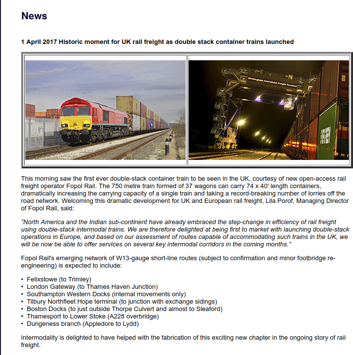

I take it that you didn't note the date on the article then? Or the crappy photoshop of the containers onto the existing image?
Dan
Toronto, Ont.
It was right at the top of what I posted. I take it you have problems reading details?
1 April 2017 Historic moment for UK rail freight as double stack container trains launched
Perhaps in your haste to make take a cheap shot, you missed the point of the post?
Than you all for making the point:
Difference with U.K. apart from state ownership of the track infrastructure is that they don't run double stack freight (so overhead wire height only has to clear 9ft6 containers on flats where that clearance has been implemented) and indeed some freight flows actually use electric traction. Difficult to compare to this freight bound network in Canada which tolerates passenger here and there
GO is on record of intending to use the standard UIC height, albeit it might have to be lowered in sections to clear bridges and the Union Station roof. This is commonly done elsewhere, especially in tunnel.
The picture was supplied with the article linked. Does that negate their facts?
Please, I'd like to hear your explanations...
Here's the article completely intact:
http://www.intermodality.com/news.html
Dan
Toronto, Ont.
The date is April 1, 2017 which I note is April Fool's Day.
When I ran the image through a reverse photo search as noted in my post above, the result that came back indicated that it appears the original image was photoshopped, as Dan indicated. Maybe there are double stacked containers in the UK that run below wires. I just don't think that image is the best one to use to provide a reference.
2HZmKdC
^ Neither do I. That's why I included all the *written* and linked reference that I did.
There are, and they are private. And freight only. Massive one in the NL (highly controversial for many reasons, a story in itself) and China too, but I digress. All detailed and linked in my prior post, but you (plural) were so possessed of making such an issue over the pic that perhaps you missed what it was all about?
2HZmKdC
The article was written as a joke - there are no locations anywhere in the UK where double-stacked containers can be run, regardless of where the wires are. The date that the article was written should have been a first clue.
Dan
Toronto, Ont.
Not at all. When the possibility of a photoshopped image was indicated I simply ran it through the site I mentioned. Took mere seconds. Just thought it would help those following the discussion. Turns out it was much easier and quicker than I thought to confirm Dan's point that it was photoshopped. The image to the right of it on the site didn't turn up any results.
