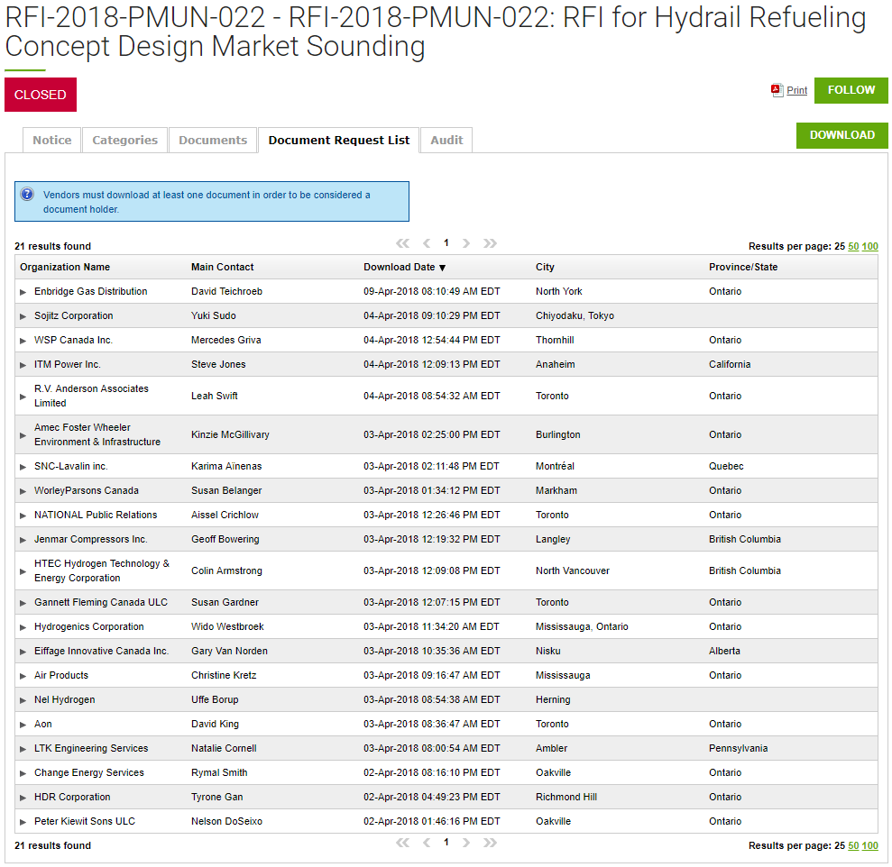

It's always interesting to view the Document Requester List
(the parties that paid $40 to MERX to download the RFI document):
Most parties paid their document download fee on April 2-3-4, with only one last-minute downloader on April 9th.
