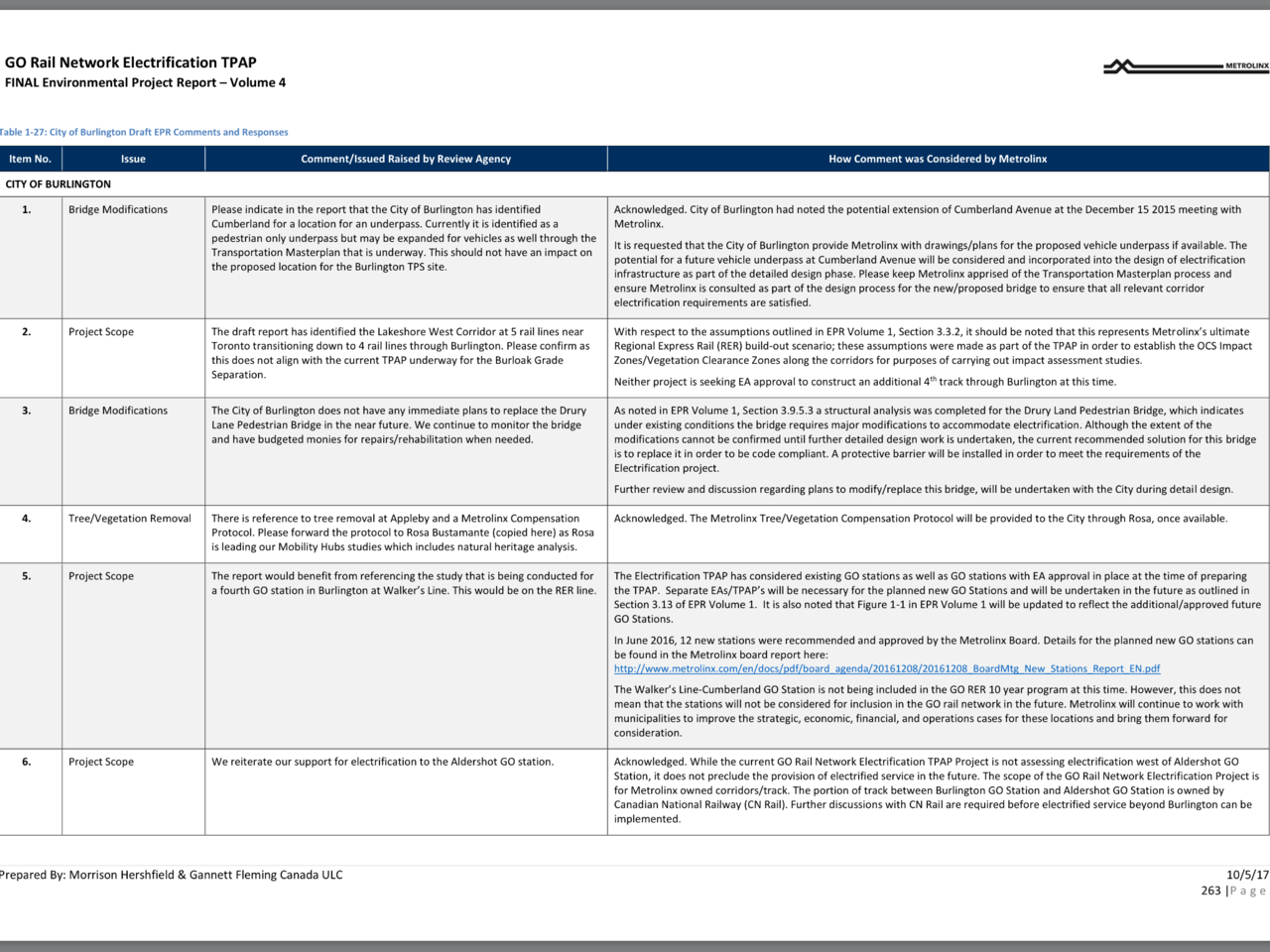

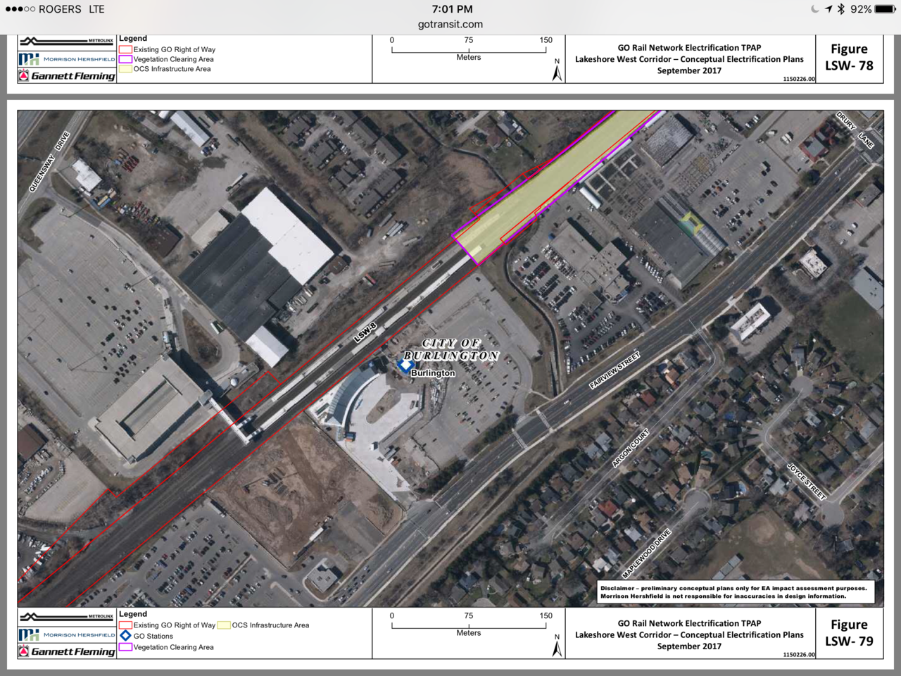

I dove into the thousands of pages of documents, to dig for Aldershot electrification plans.
It's going to be messy decision making for how Aldershot GO is phased during GO electrification -- either dual mode trains occurs, Aldershot gets downgraded to hourly diesel train service, or electrification reaches Hamilton when Aldershot is electrified.
TPAP stops abruptly at Burlington GO station.
