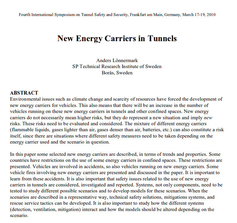

Edit to Add: I've just realized a highly troubling aspect for "Hydrogen Powered GO Trains". And this for inner Toronto, underpasses and tunnels, let alone Union Station, could be a real show-stopper:
For the same reason hydrogen vehicles are banned from underground parking, hydrogen powered trains would also have to be due to the hazard of leaking gas, either from poor fittings, or from a collision. Permeated salts might offer some form of controlled release, but so far, in a quick Google, I can't see Metrolinx addressing the point.
I'm only just starting to delve on this, but already, some very troubling research. Here's one:
https://www.cob.nl/fileadmin/kennisbank/New Energy Carriers in Tunnels.pdf
Metrolinx had best keep its mind on the tracks ahead, and get them electrified in the tried and trusted way, and keep the promises made...

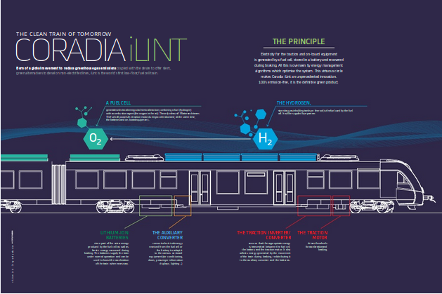

Japan actually ran a number of prototypes using hydrogen fuel cells for a couple of years before the iLint. Here's detail on that and more:
The iLint is powered by massive lithium ion batteries, which get their energy from a hydrogen fuel tank installed on the roof. On a full tank, which requires about 94 kg per car, the hydrail can operate for an entire full day, or travel up to 800 km. Its top speed is reportedly 140 km/h (87 mph).
Hydrogen-powered technology for trains has been around for just over a decade now, but rather than being used to ferry us humans around, full-hydrogen and hybrid versions have so far only been used in the freight industry.
As Christina Beck from The Christian Science Monitor reports, back in 2004, the Japanese Railway Research Institute developed a prototype fuel cell, and it went into use two years later. And last year, China started using hydrogen to power its trams in an effort to curb its severe air pollution problem.
The difference here is that Germany's Coradia iLint will be able to transport 300 passengers at a time, and will be the first fully hydrogen-powered train to complete run long-distance routes
Here’s a quick run-down of how the technology works (larger version here):
Alstom Coradia-iLint Decryption en OK by ahawkins8223 on Scribd
https://www.sciencealert.com/the-world-s-first-hydrogen-powered-train-is-coming-to-germany
