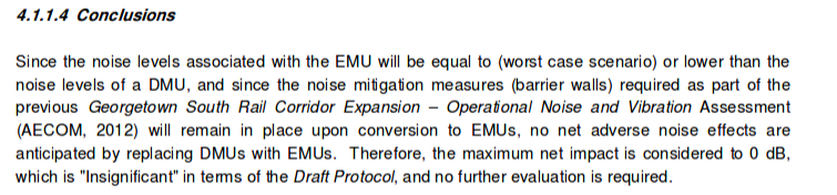

This has been looked at by professionals. There are quite literally hundreds of pages of reports generated on this question over the past 10 years.
From glancing through those reports, EMUs will be as quiet as the present DMUs on UPX, which are considerably quieter than Diesel loco hauled.

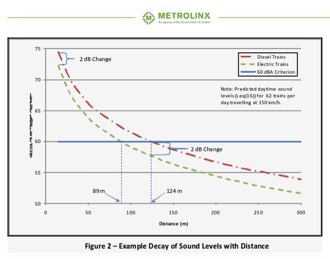

http://www.gotransit.com/electrification/en/project_history/Appendix Files/Appendix 8E.pdf

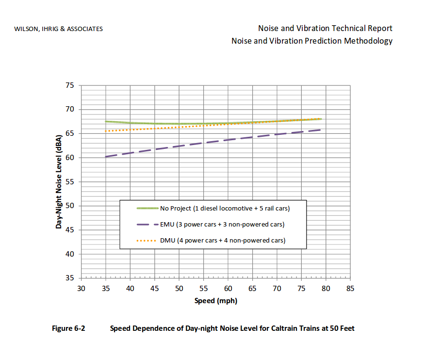

(Caveat: That's for electric loco v. diesel loco hauled trains @ 150 km/h. That's 94 mph, highly unlikely for RER EMUs. The bulk of the noise level generated is mechanical, thus an un-linear comparison to propulsion noise at slower speeds, which will be much more in favour or electric, and even more in favour of EMUs. I'm struck by how far GO biases the outcome to downplay the sentiments of the Weston pro-electric and other sources (many in the world, with actual as well as theoretical results) clearly showing the considerably reduced noise and vibration signature for electric, especially EMU, let alone the cleaner air)
Entering "Clean Train Coalition" into Google shows many different orgs in the developed world, my intention was to pursue what the Weston one was stating on noise and vibration, but I see there's a Junction one, a Sorauren one and others in Toronto, let alone ones elsewhere. Not surprisingly, they ALL mention "quieter and less vibration" as features of electrification.
Lots of "codswollop" (sic) eaters in the "universe"...I'll get back to this line of discussion when someone posts a more technically apt argument based on neutral sourced research that lends itself to more objective analysis.
Edit to Add: Excellent much more technically savvy, neutral and detailed report on the subject from Caltrain, 160 pages, specifically on the subject being discussed here, and done by a highly reputable and independent company:
Pg 66, http://www.caltrain.com/Assets/Caltrain+Modernization+Program/DEIR/Appendix+C+Noise+Study.pdf
Note the EMU spl per speed curve above.
I highly recommend this report and deep analysis for anyone who considers themselves seriously concerned on the topic.
