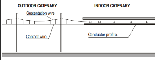

I believe they're going to adopted "Rigid Overhead Conductor" within the legacy shed. instead of catenary-supported conductor.
Someone please correct me if I’m wrong but it looks like the same style of rigid overhead conductors are used on the Finch LRT. I just noticed in this photo from the new CLC, could very well be the same in other locations on Eglinton though I haven’t taken notice.
Looking north at Finch and Hwy 27:
The whole area on Hwy 27 from the Finch portal is rigid overhead that can be found on the Crosstown line as well at TTC St Clair West loop. If you look at the Mount Denise Station, you will see the station is 100% ridged. I wouldn't be surprise if most of the underground is rigid overhead.
