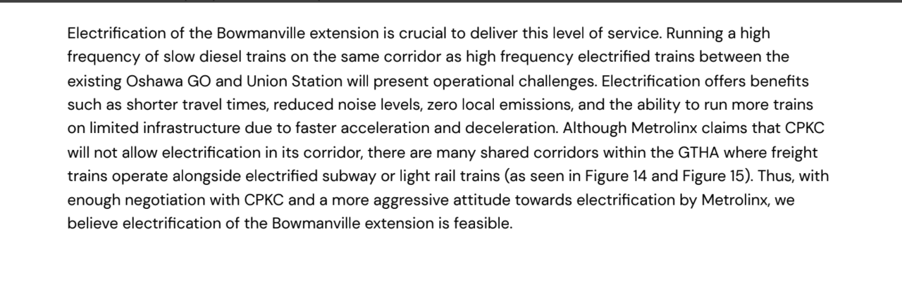

mystery solved: the reason GO Bowmanville is out of scope for electrification is a Metrolinx failure to adopt a sufficiently steely glare when negotiating with CP.
I mean, I hope this is right because if Metrolinx actually adopt this obvious approach, we get also better/electric GO Milton, plus GO Bolton and GO Midtown.

I've heard that CN and CPKC's issue with electrification and their tracks isn't so much about wires above freight trains, it's the requirement that crews who work on these tracks need special training and this adds costs and time. It's a bit of an apples to oranges comparison for the Waterloo example because that's a small branchline and not a mainline which is what the CPKC mainline is. They want to ensure that there is no disurption or added complication to their key mainline.
For the Waterloo example given, the tracks don't appear to be owned by CN. Wouldn't it be safe to assume that Waterloo is responsible for the maintaince and the crews?
I'm not saying I fully agree with these arguments CPKC making rather just that it's not as easy as suggesting a more aggressive attitude will solve this. cc @smallspy @crs1026
Exactly. There are incentives and disincentives for the host railways that are meaningful. Forcing an unwilling railway into this kind of complex proposition will have consequences - for every action there is a reaction. One has to find a solution that gives maximum incentive and mitigates the disincentives. Only when that is done can one maybe add some pressure.
There are very significant differences in the operating format between the Waterloo Spur and what GO would need on the mainlines. Voltage being one of the items. I don't pretend to understand the railways' exact concerns, but in aggregate it is indeed a headache they just don't need. The fact that it is done in Waterloo does not necessarily set precedent for the main lines.
