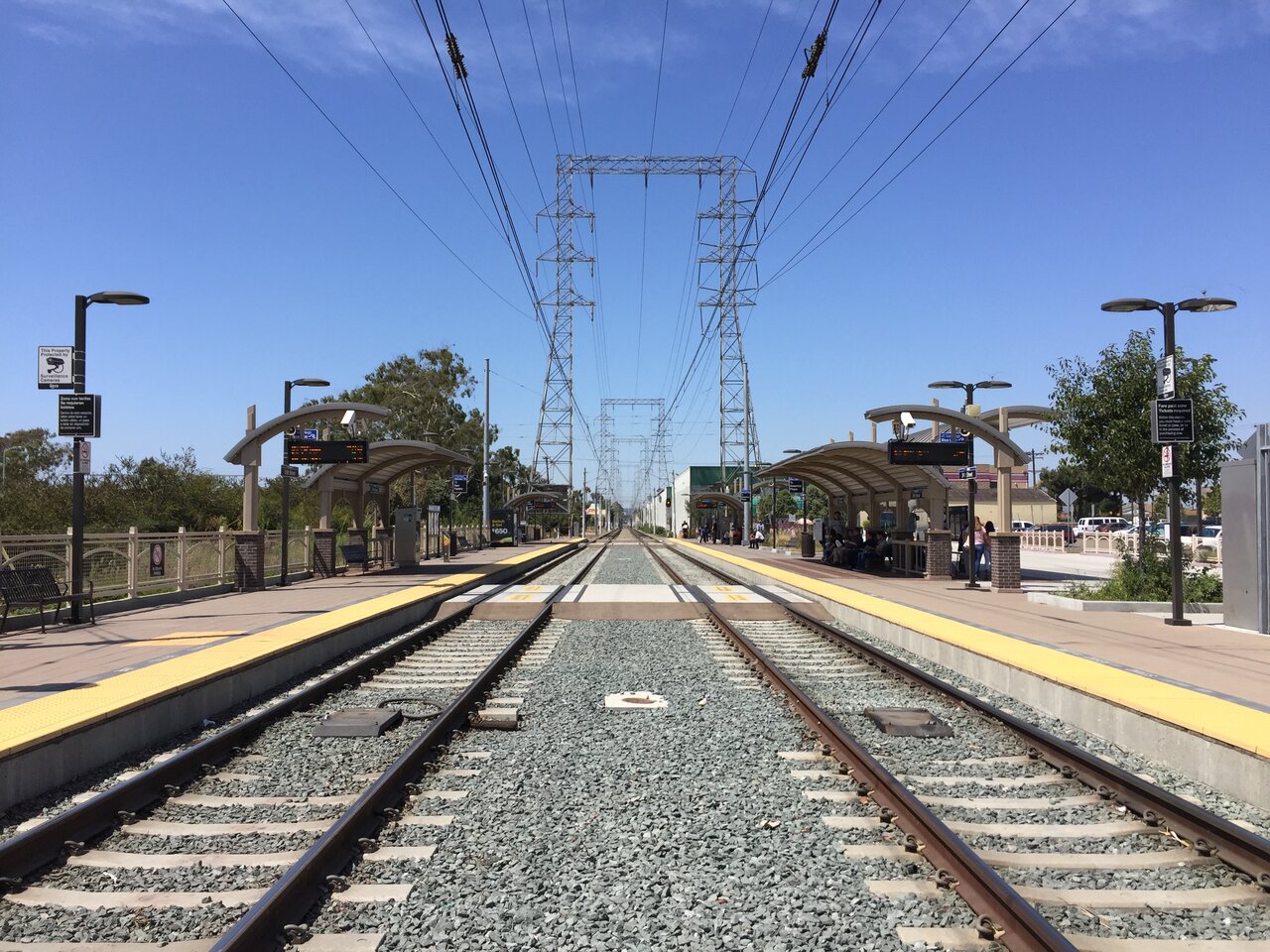

They should do what San Diego did, have to tracks run in-between the pylons;
It's like Hydro One doesn't realize there is actually more than one type of hydro electric plyons out there 🙄
