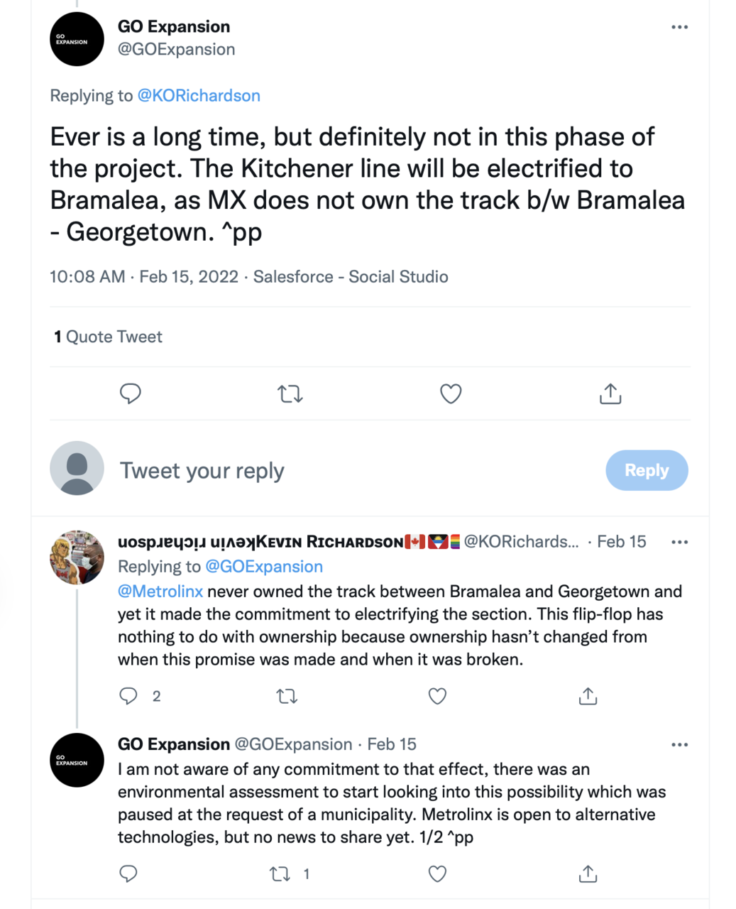

Electrification will stop at an arbitrary point between Milton and Bramalea?? That makes no sense. I have a hard time imagining that they will not electrify into Bramalea station. Surely they can do something like Lakeshore East where the CN owned tracks and Metrolinx tracks are next to each other but owned independently. Move the weave past the station, move the tracks further south a bit, etc. There is room under the 407, and Bramalea Road bridges to keep tracks apart.
It would make no sense to stop the wires just short of Bramalea. My guess is that this is just a cautious illustration pending future negotiations with CN. I'm sure they'll manage to come to some sort of agreement, given that CN hardly ever uses the southern 2 tracks at Bramalea themselves, but Metrolinx might be hesitant to promise things which haven't yet been fully negotiated.

West of Bramalea yes, but the question today was regarding electrifying the two southern tracks in Bramalea station itself, which are technically not owned by Metrolinx. Without that short segment, GO would need to use diesel, dual-mode or battery-electric trains on the Bramalea-Union local services rather than cheaper and more-efficient electric trains.

I would think that even with a third track through Brampton they wouldn't electrify the route there because CN owns that section of the corridor. I'm thinking only about the southern two tracks in Bramalea station.

"Metrolinx is open to alternative technologies". I don't think they mean diesel so why not just say batteries.
i believe thats the wording MX has used since first proposing RER, is that "its up to the bidders to tell us which tech is the best"
weirdly, they had an article sent out last fall about how they have settled on catenary, as in the bidders must have told them that battery/hydrail doesnt work as well as catenary
