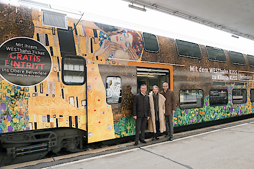

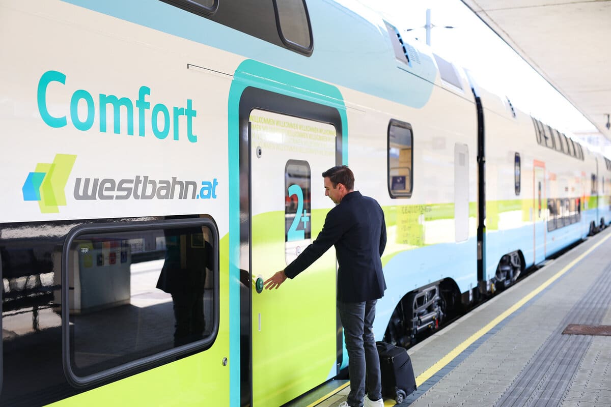

Googling around, I did come across some photos of Austria’s Westbahn Stadler KISS at both a high level and low level platform. Doesn’t seem to be a problem for them.

The KISS DD that I have been on as well seeing them in various countries along with other trains have a sliding gap plate at all doors regardless if they have high or low platforms. This applies to newer equipment less than 25 year old.
I have seen Austria’s Westbahn Stadler KISS first hand with videos and photos going back to 2012.
