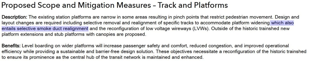

Yes that's correct. They have been proceeding on the design already, and the preferred solution for the heritage shed is to install an overhead rail within the smoke ducts above the tracks, though those ducts need to be shifted in a few places to properly line up with the tracks. The new platforms south of the shed will use ordinary overhead wires.

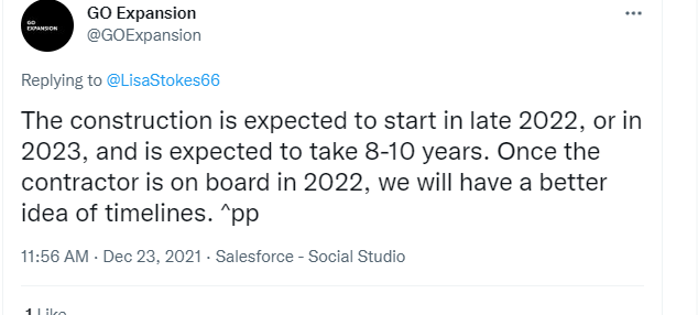

Even the shortest pair of viable segments (25 km Bramalea-Union + 31 km Union-Unionville) is already 56 km of lines, which is more than CalTrain's entire electrification program. But given that the Whitby Yard will likely be the initial base for electric trains, LSE (50 km) would probably be part of the initial operating segment, and if LSE is electric, they'll want LSW as well to avoid terminating at Union (+35 km to Oakville). So even if the initial operating segment is just the Lakeshore East and half of Lakeshore West, that's already 85 km. More likely it would be both of the above, plus the Pearson guideway, for a total of 144 km.
Caltrain's electrification is currently scheduled to last 8 years between awarding the contract and running the first train in service. That's for 49 km of double-tracked lines (around 120 track-km mainline plus maintenance/storage facilities).
GO's electrification is for 260 km of lines of varying widths (687 track-km), and electrifying Union Station will be considerably more complex than electrifying San Francisco's King Street station, which doesn't even have a trainshed. The new south platforms at Union are being designed with overhead wires from day one, but at least some of the historical plaforms also need to be electrified before a single electric service can start running. I suspect that the planned reconfiguration of the USRC west of the station would be the limiting factor for the speed implementation, given that Metrolinx won't want to electrify tracks that they're about to demolish anyway.
As depressing as it sounds, I wouldn't be surprised if 2031 is indeed the start of electrified revenue service on the central portions of the core network (e.g. to Oakville, Bramalea/Pearson, Aurora, Unionville, Oshawa) with the remainder of the core network (to Burlington, Barrie, Lincolnville) coming online incrementally afterward. From a railfan perspective, the bright side is that electric trains will start testing much earlier than that. My guess is that they will start by electrifying between Pickering to Oshawa as a testing segment since the Whitby yard is already designed for electric trains.
The ducts are already aligned with the center-line of the tracks. And the new ducts installed during the trainshed rehab are several inches shorter than the original ones, to allow for clearances around the catenary/rail system that will be installed.

I actually change my original estimate. I'm going to say 2034/2035 until we see a line electrified.
To clarify: they need to shift ducts to align with the tracks which are being realigned.
From https://www.metrolinxengage.com/sites/default/files/unionstation_ministers_consent_27nov20_0.pdf
Design and layout changes are required including selective removal and realignment of specific tracks to accommodate platform widening whic h also
entails selective smoke duct realignment and the reconfiguration of low voltage wireways (LVWs).
