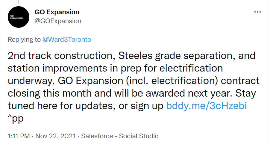

OnCorr contract closes this month.
What is the distinction between closing and awarded above?
Awarded sounds like when money rolls out the door, so that’s the milestone to wait for, no?
I believe "closing" refers to the financial closure of the project vs the announcement of the winner.
curious as its normally the other way around. they announce the winner then closure happens later on.
Possibly misspeak. The tender is probably closing (no longer accepting new paperwork from bidders) and after evaluating the submissions the winning bidder will be awarded next year.
Closing a contract usually refers to final signing (all conditions met or waived, financing/deposits in place, can no longer back-out) which happens well after you award the tender.
It's extremely rare for a government contract to reach financial close before the winning bidder is announced. The winning bidder needs to start hiring sub-contractors to close out contract conditions which requires telling them what they'll be working on.
