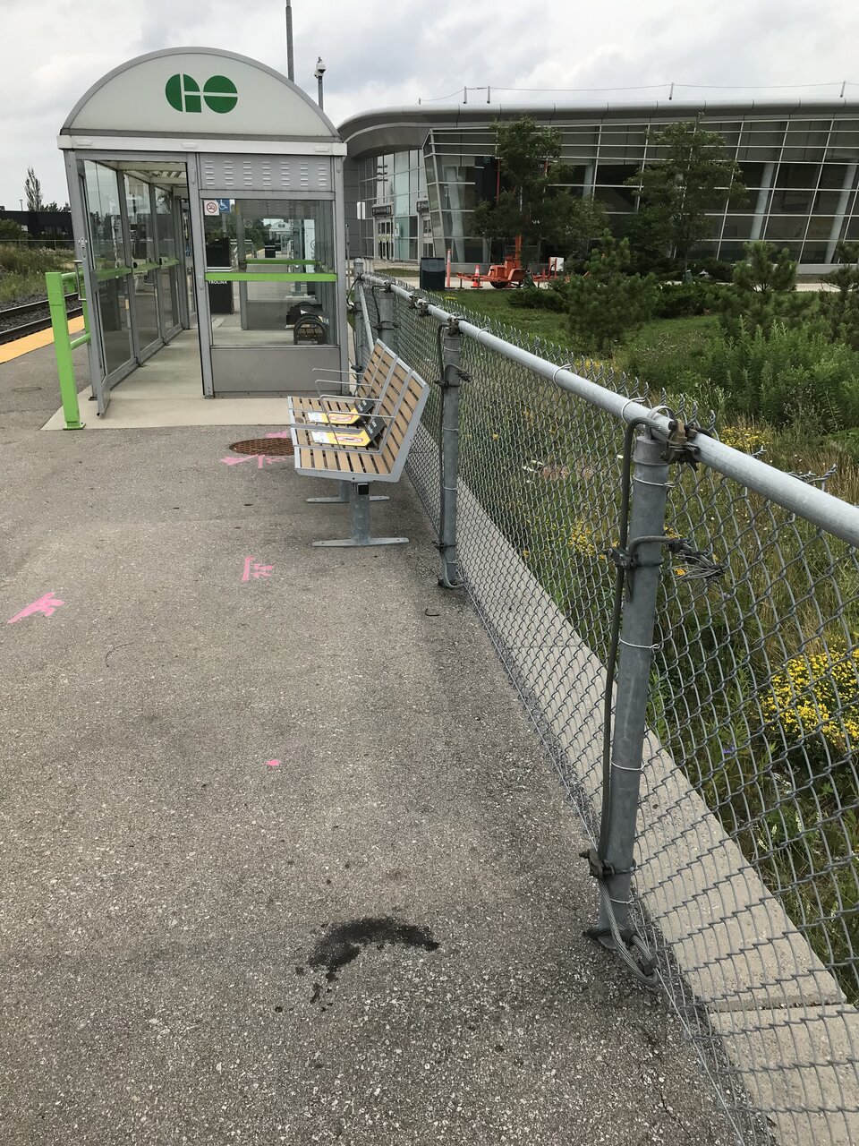

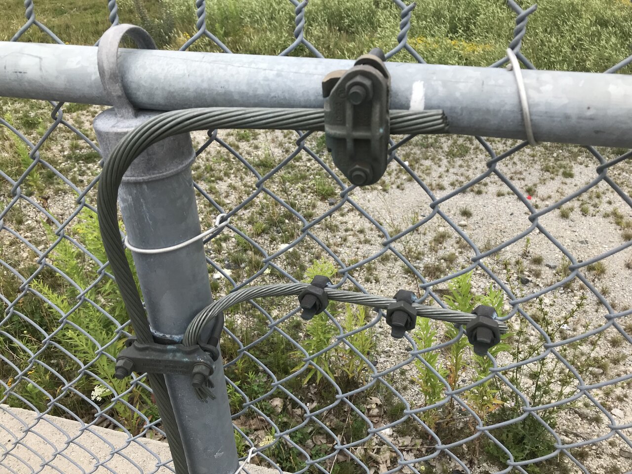

While waiting for the train at Downsview Park today, I spotted this mysteriously elaborate grounding on a section of chain link fence. The only explanation for this that I could imagine is that it’s a trial or future proofed installation with electrification in mind.
None of the many shelters, light standards, or platform appurtenances were grounded in this way, and there were no overhead wires in the area. So I discounted the possibility that it was lighting protection or a code requirement due to particular exposures in that spot. I have to think that it’s a test. But it gives a hint of just how much work is requires to electrify a line, beyond just setting poles and stringing wires.
