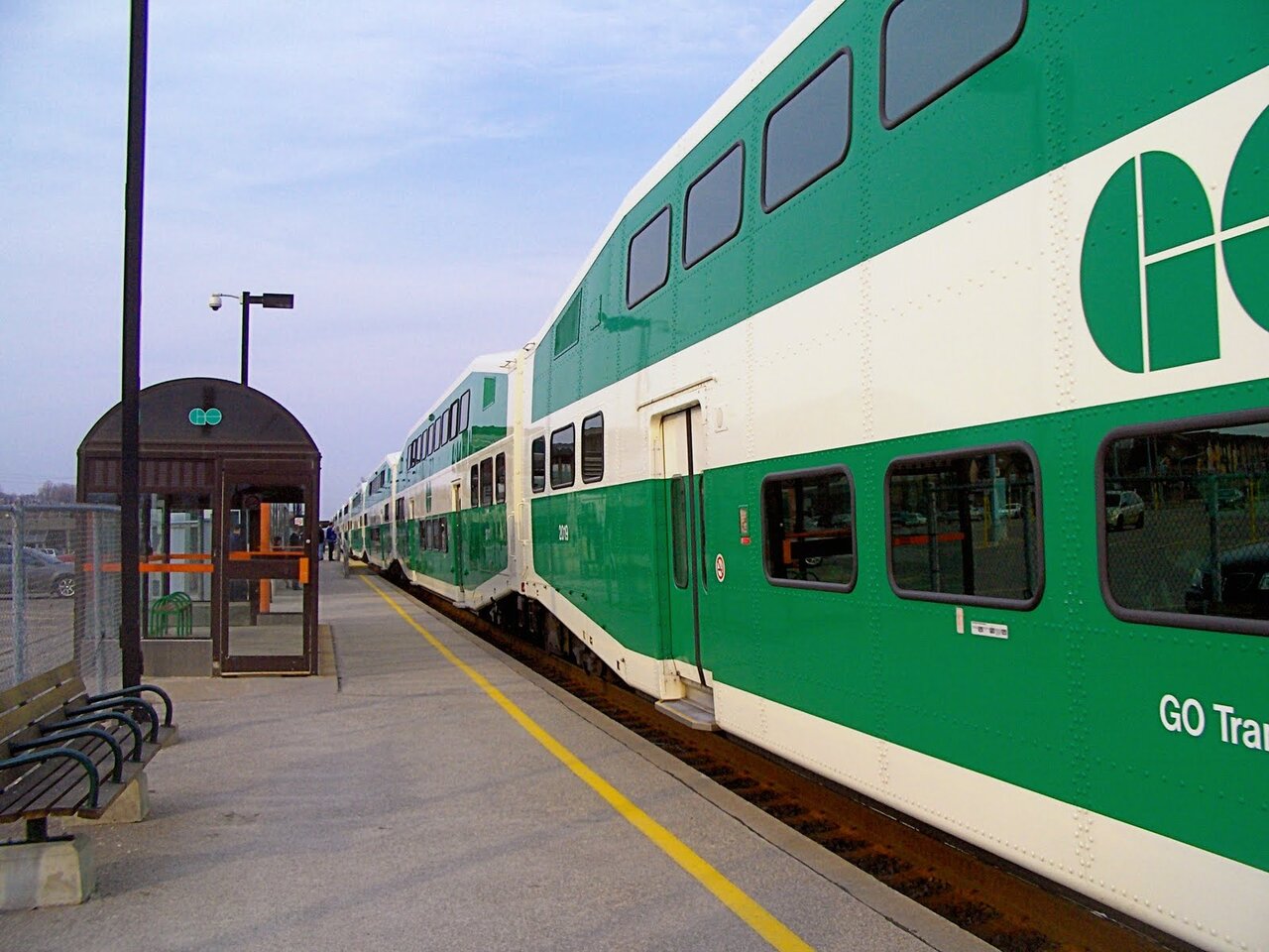

One of the many problems with bi-levels however is that are uniformly slower than single level trains due almost exclusively as a result of much longer dwell times. This inhibits frequency levels and speed making them less appealing to the general public.

I don't think its a problem with Bi-Levels in general, but just our implementation of it. Our doors are on the lowest level which forces people to climb up to 2 flights of steps to get to a seat if they don't want to sit on the lower level. Comparatively Bi-Levels like seen in Sydney have there doors at mid-level which should make boarding faster since passengers disperse in 2 directions (up or down) instead of everyone going in one. Now obviously this is all moot since GO RER doesn't include high level platforms due to logistical issues.
that would only work if we have high platforms. Unless raising all platforms is part of the scope of this project, low entry doors is the way to go
Does anything prevent bilevel coaches from having more doors on the lower level? Upstairs more long-distance seating and bottom level more metro layout?
Doors: the design has never taken additional lower doorways into account. It does allow for doors above the trucks (for high-platform loading), but no more than that.
Seats? Absolutely - the car design is for a series of open tubes that allow for any number of different configurations.
