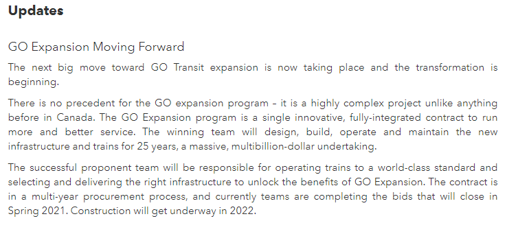

Crossposting from the Jane LRT thread, an update on the bidding process for RER.
Edit: Yes I did check the Wayback Machine to see if this is updated.
