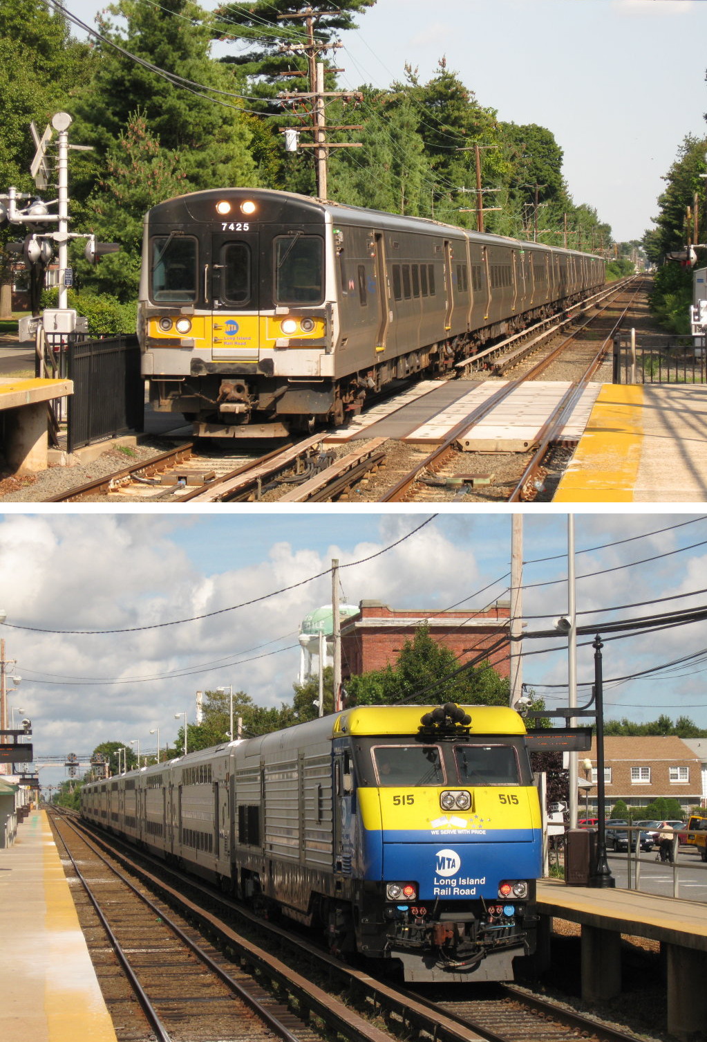

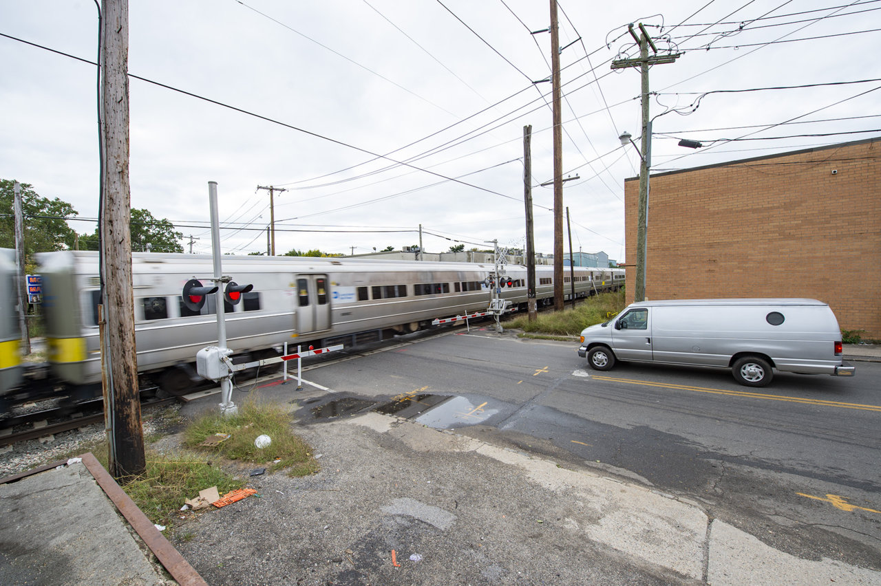

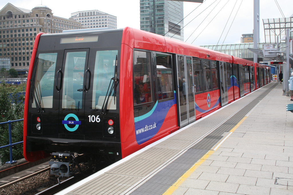

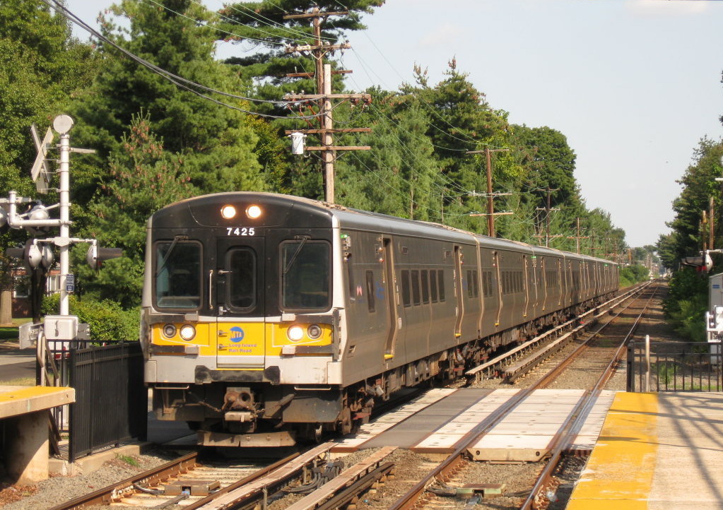

They exist, and if you had to electrify GO with 3rd rail, you could, it would just be a huge non-starter and would be insanely inefficient. However, it'd still be more practical than full Hydrogen or Battery electrification.
I would say that the London Docklands line counts more as a grade-separated light metro line similar to a traditional subway, whereas the latter two (MTA and Chicago) really count more as legacy systems full of compromises that would not be built as-is today.
Only the ground level power supply could be considered, and even it's for streetcar loads, not full mainline cars- and more for aesthetic rather than efficient reasons.
Regardless, the discussion over power supply has always been silly IMO. Plenty of postulation over no information.
