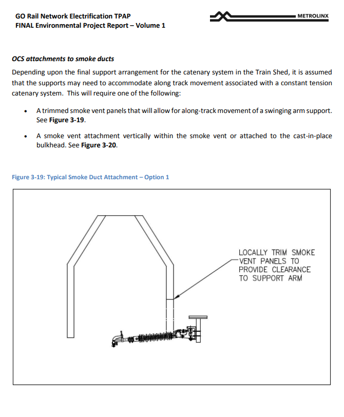

Found it (cc @dowlingm). See my October 12, 2017 post here in the GO Transit: Union Station Shed Replacement & Track Upgrades (Zeidler) thread. Also posted by @AlvinofDiaspar.
I had extracted the files here: https://viarailcorridor.files.wordpress.com/2017/10/union-station-shed-and-ocs-volume-1.pdf
Key image of option 1. There is an option 2 you can see in the file above.
