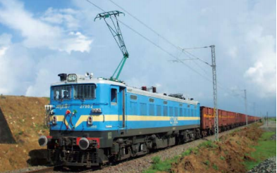

And here's your reference:
A test programme has confirmed the feasibility of operating electrically hauled double-stack container trains, leading to Indian Railways’ decision to wire the Western Dedicated Freight Corridor at 25 kV 50 Hz.
https://rdso.indianrailways.gov.in/works/uploads/File/Railway _Gazette_Double_Stack Container(1).pdf
What do you think "Dedicated Freight Corridor" might mean?
Here's a pic from that reference:
188897
For some odd reason, using a panto that tall for rapid passenger use let alone high speed use aggravates the laws of physics. They will fail, spectacularly, and if not pushed to the failure point, they add a huge amount of drag and stress.
