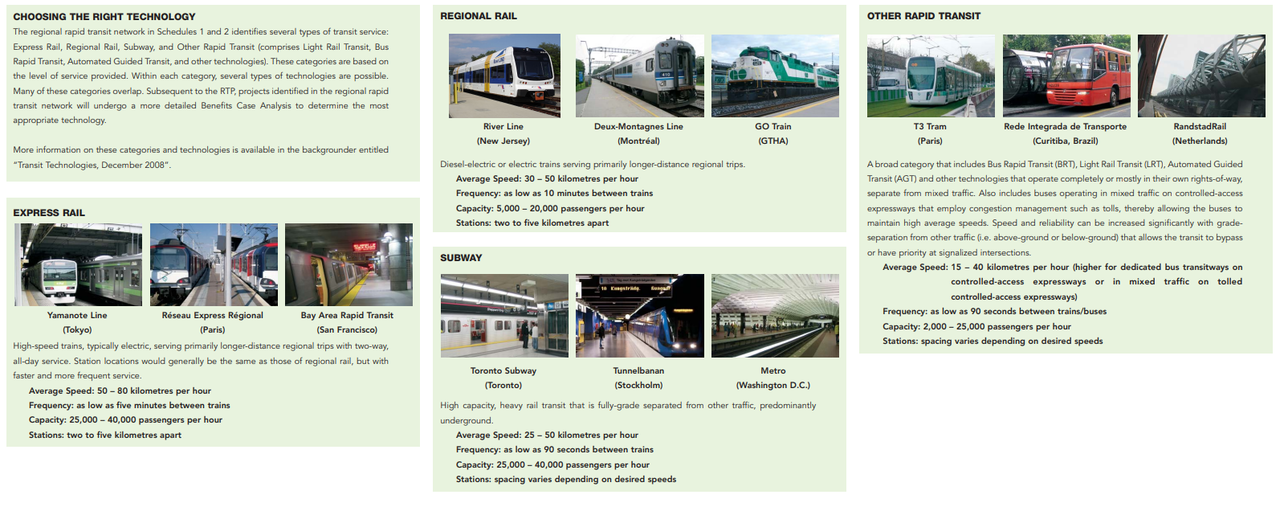

While I would need to do some mapping and thinking to take a firm position, I'll insert some (what I think is) relevant content from the original Big Move (2008 Metrolinx Regional Transportation Plan):

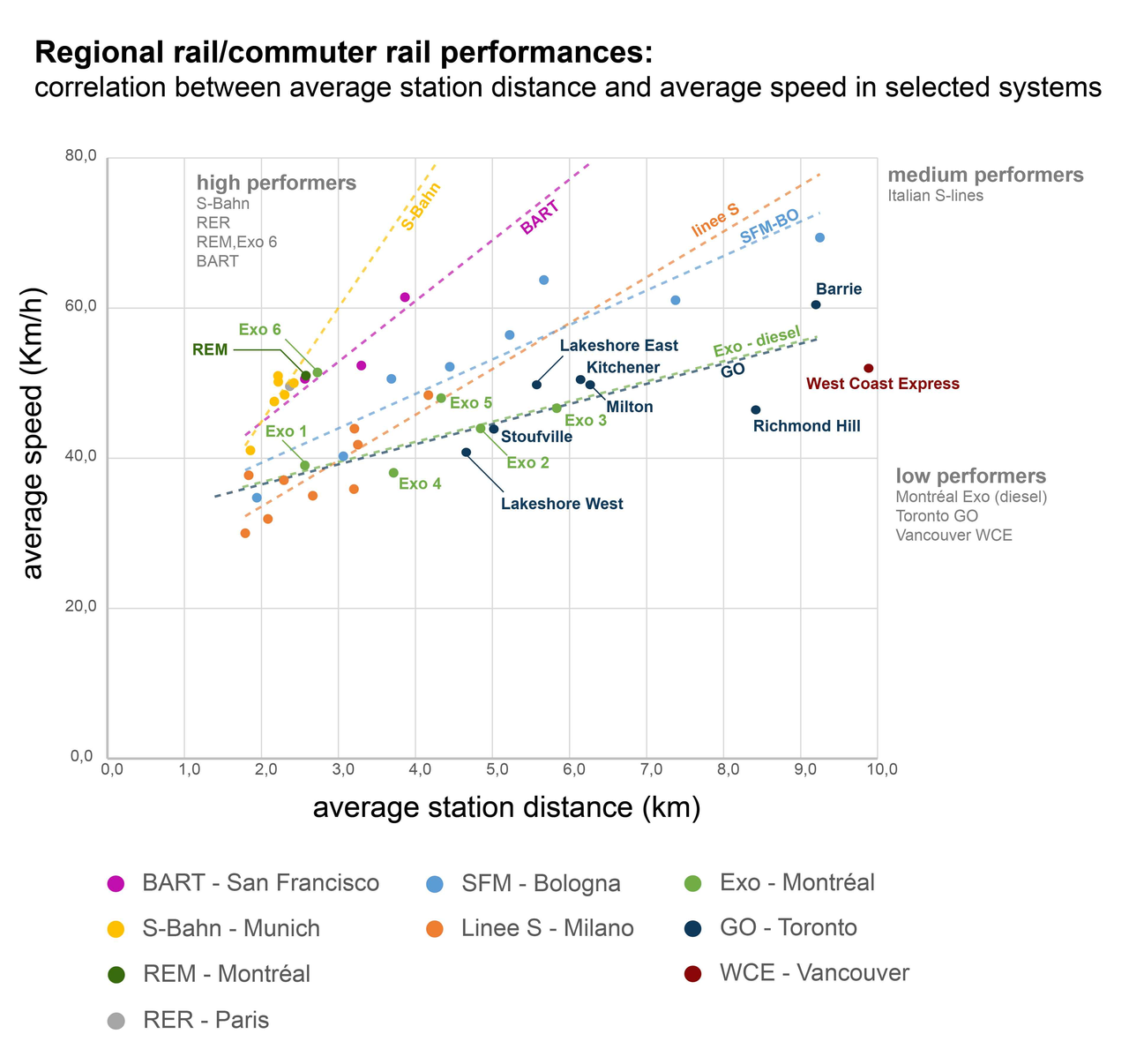

GO is slooooow, with terrible performance of huge, underpowered trains the culprit. Modern electrification, trains, and signalling as on the Munich S-Bahn delivers higher speeds than GO with triple the stations. Not quite a magic bullet, but certainly reason to jettison reflexive opposition to infill stations.
Doing a bit of spot-checking. The average station distance for REM is 4.2 km, not (about) 2.6 km. That does put that graph into question. (though I suspect that the general trends are correct).
The REM's initial segment is 16.6km with 5 stations, so 3.2km. The error, I believe, is that the unbuilt Griffintown station's been included, with which you'd have 2.75.
