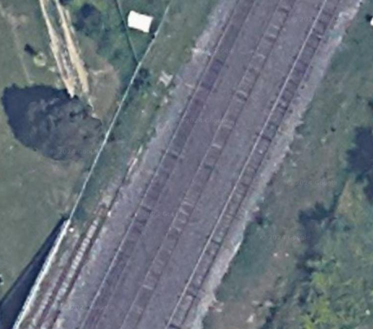

This is the west side of Midland, and you can see here there is no operational 4th track:
That fragment of track is not connected to anything at either end.

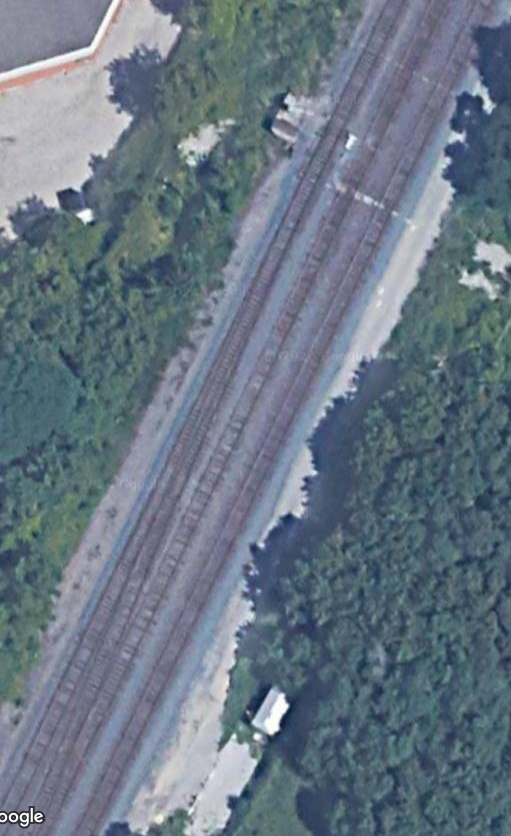

Below is the LSE just west of Scarborough GO:
3 tracks are in operation here today, but ROW prep (grading etc.) is underway for additional track.
The 4-track segment is only on approach to and through Scarborough GO.
