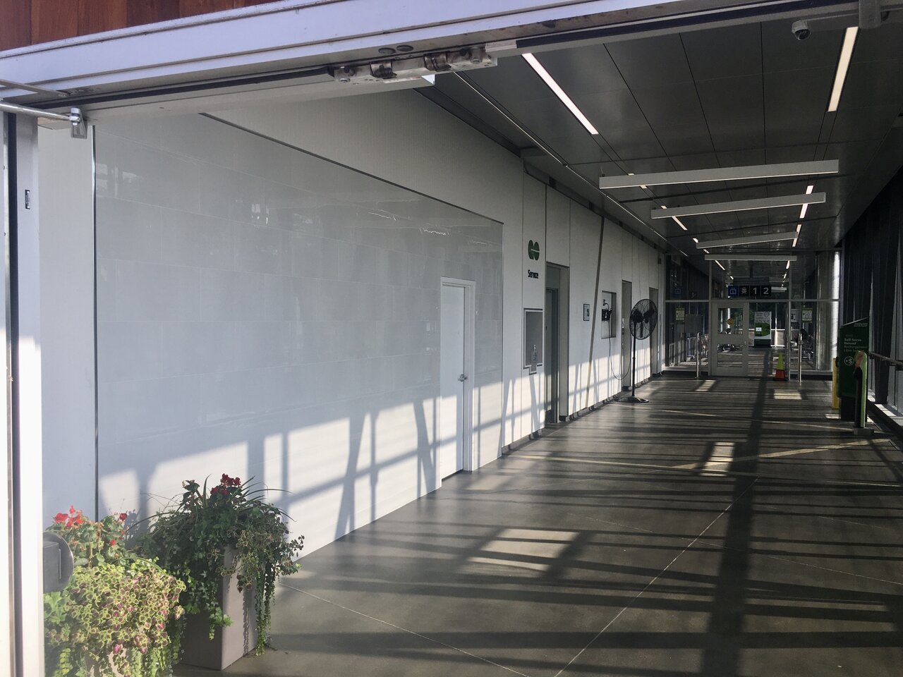

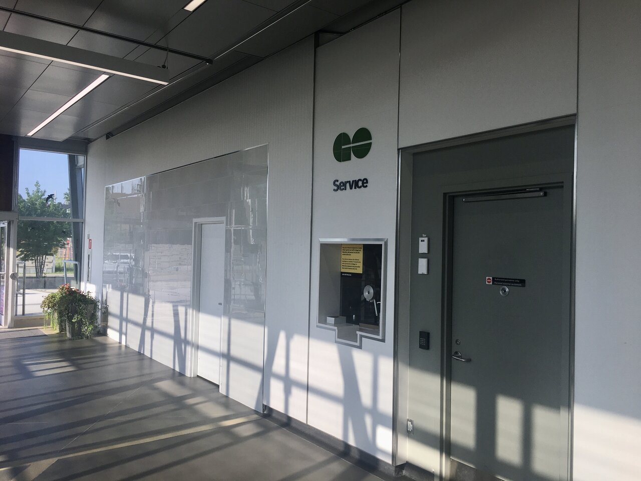

At West Harbour GO, they have re-opened the main entrance following renovations. Gone is the former alcove with ticket booths, which have been replaced with a single service booth with a tiny window.
Unfortunately I can’t find any “before” pics of this area.
I know there have been some safety concerns in the main station area, as well as the staircases, so I’m unsure if the temporary closure was due only to construction.

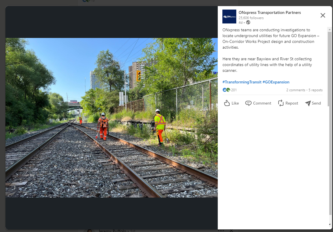

Interesting location that hasn't got a lot of coverage. Update from March 1st:
To enable rail service increases during design and construction of the new layover, the Rosedale Siding (located between Bayview Avenue and the Don Valley Parkway) will be used temporarily to stage GO trains during the day. GO Trains will be staged at the Rosedale Siding for about two hours in the morning peak period, and another two hours in the afternoon peak period.
Picture from four days ago today.
Related to the location of this picture, it would have led to the original location of the Don Valley Layover on the Don/Belleville Spur.
Of course, this stretch may also be used by VIA HFR to get to the Don/Belleville Spur cc @crs1026 @smallspy
