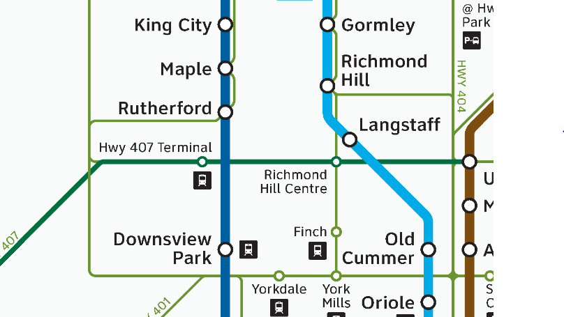

It always was weird that the 407 GO buses never connected to the Barrie line in any way, but every single other GO line has a connection. Yes there is the Line 1 extension that makes it somewhat easier to get to the nearest point on the Barrie Line which is Downsview Park from 407 Station, but the issue is that its not direct and fare integration is still an issue. And no the new 66 routing does not count despite it now coming from 407 Station, its best not to talk about that line. We need a proper Barrie GO line connection to the 407 Transitway in the future for sure.

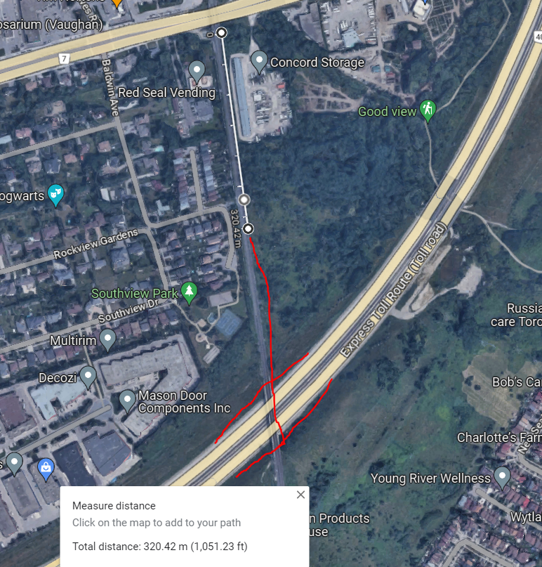

My question is, why not do something like this?

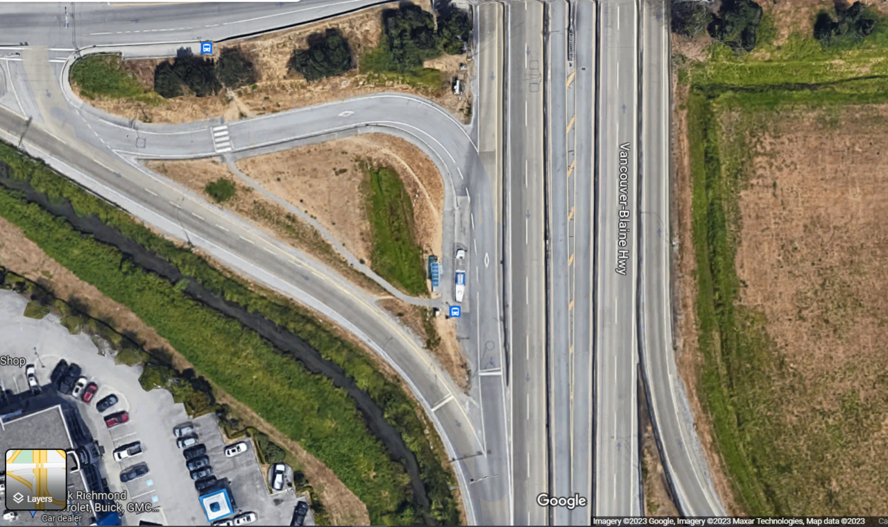

Have bus stops straddle the side of the 407 Vancouver Style, then have a pathway alongside the Barrie Line tracks connecting the 407 stops to the station which is now located on the south side of Highway 7. The walk will be 300m which while it isn't great, wouldn't be much longer than the walk between RHC and Langstaff GO, and speaking personally, I'd find a stop that can serve the station without wasting much time to be preferable to a long detour that brings you closer to the station. Plus, it means that any future 407 Transitway wouldn't have to awkwardly detour under Highway 7, and the section could be built much more direct and cheaper.
The "Vancouver Style Bus Stop" for context:

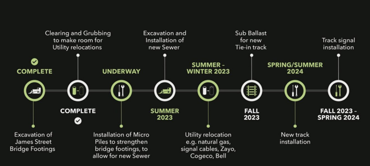

If you read the description, it actually says "fall 2024". So not next year, unfortunately.
Confederation GO is supposed to be completed some time in 2025.
I thought the timeline above was sufficiently pokey already.
The reason this Confederation station will be completed sooner than later, it not effected by GO trains daily. At present time, station work is effected by the odd CN train until CN lines get shifted back to the main corridor once all the work is done that will ben under the corridor that is taking place today. After CN tracks are move or left there with new CN tracks, there no worry about trains. I have yet to take a look at the other locations and was supposed to do it in March that got side track.
