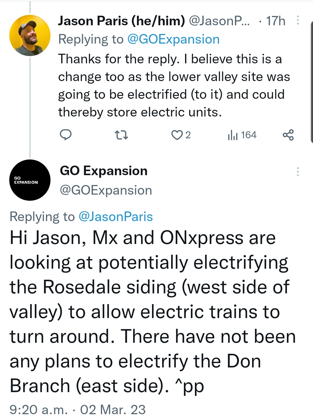

Urban Toronto gets answers! HT @JasonParis
I guess Rosedale siding wasn't appropriate for long term? It has easy access to Bayview and may be wide enough for 3-4 tracks (for a short distance).
Rosedale will be converted into double track and lengthened to the south. It can't be lengthened to the north however without some very serious earthworks, and thus cost.

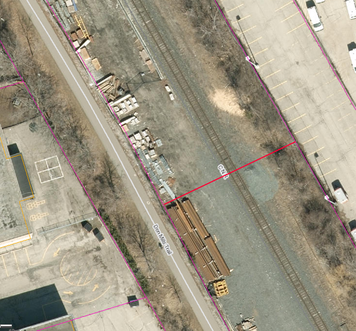

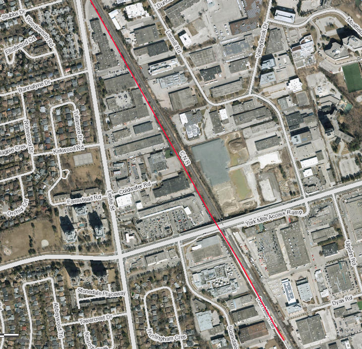

Just to give people a sense of the proposed new yard location along the Richmond Hill GO line, and its size/room for tracks:
Pink lines are property lines, the distance across the bulk of the Mx space is ~33M wide; there is a brief stretch to the south of that line where it widens out of ~48M, but it isn't terribly long.
They maintain that 30M+ width for a distance of ~1.4km
