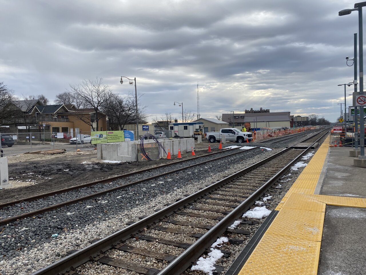

So the cp/cn connecting track is being extended to nickle. The quad track section looks almost finished from Nickle to Humberview.
Wice to Airway is triple tracked for now but there is no track 1 to 2 crossover. There is a 2 to 1 cross over which is primarily used by CN529 running Monday to Friday and 559 on Saturdays
That extension is really the new fourth track getting roughed in. The connecting track will eventually have a switch right about where it has been ie south of the Black Creek bridges, but with a signalled power switch connecting to the new fourth track, which has yet to be laid from Black Creek down to the flyunder.
There is a lot of circuitry already roughed in to the signalling at Airway and Wice. Just drop in the panel switches, and the CTC will be ready to go.
