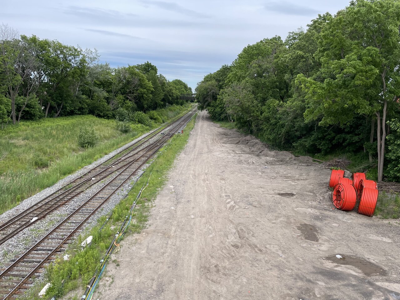

Small signs of prep work for the West Harbour tie-in started showing up this summer with cabling relocation. Picture from July.
