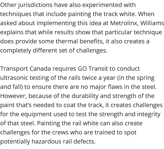

Question and not sure where it should go.
Has ML thought of painting the rail to deal with heat and buckling like Europe??
Rails in Europe have a white colour on them other than the top. This includes High Speed lines. Even subways lines not underground:

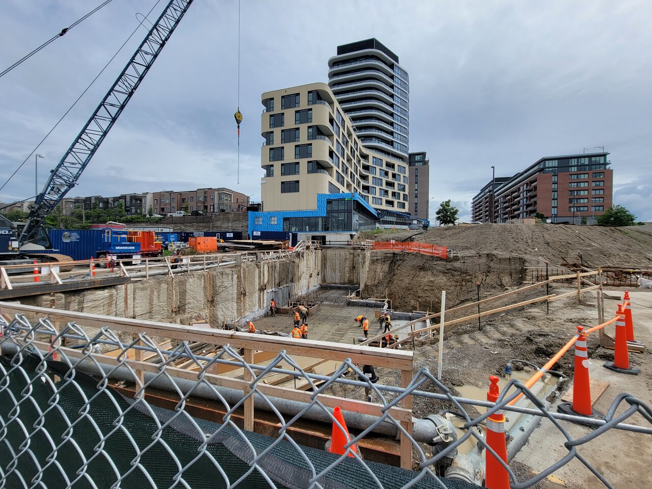

The tunnel goes the entire distance. Pic is from 2 weeks ago.
Ah okay, thanks. Not as ideal as a bridge (still need to go down to the tunnel and back up), but not that bad either.
yes but it's deemed as not feasible in the Canadian climate
They have considered it...........
That's not the reasoning Mx has given on their Blog.
From here: https://blog.metrolinx.com/2019/07/18/tracking-the-heat-and-riding-the-rails/
What the above has me wondering is ..
"Is ultrasonic testing of the rails not done in Europe?; if not why not, and what are they doing instead? If so, why is the paint not an issue there?"
