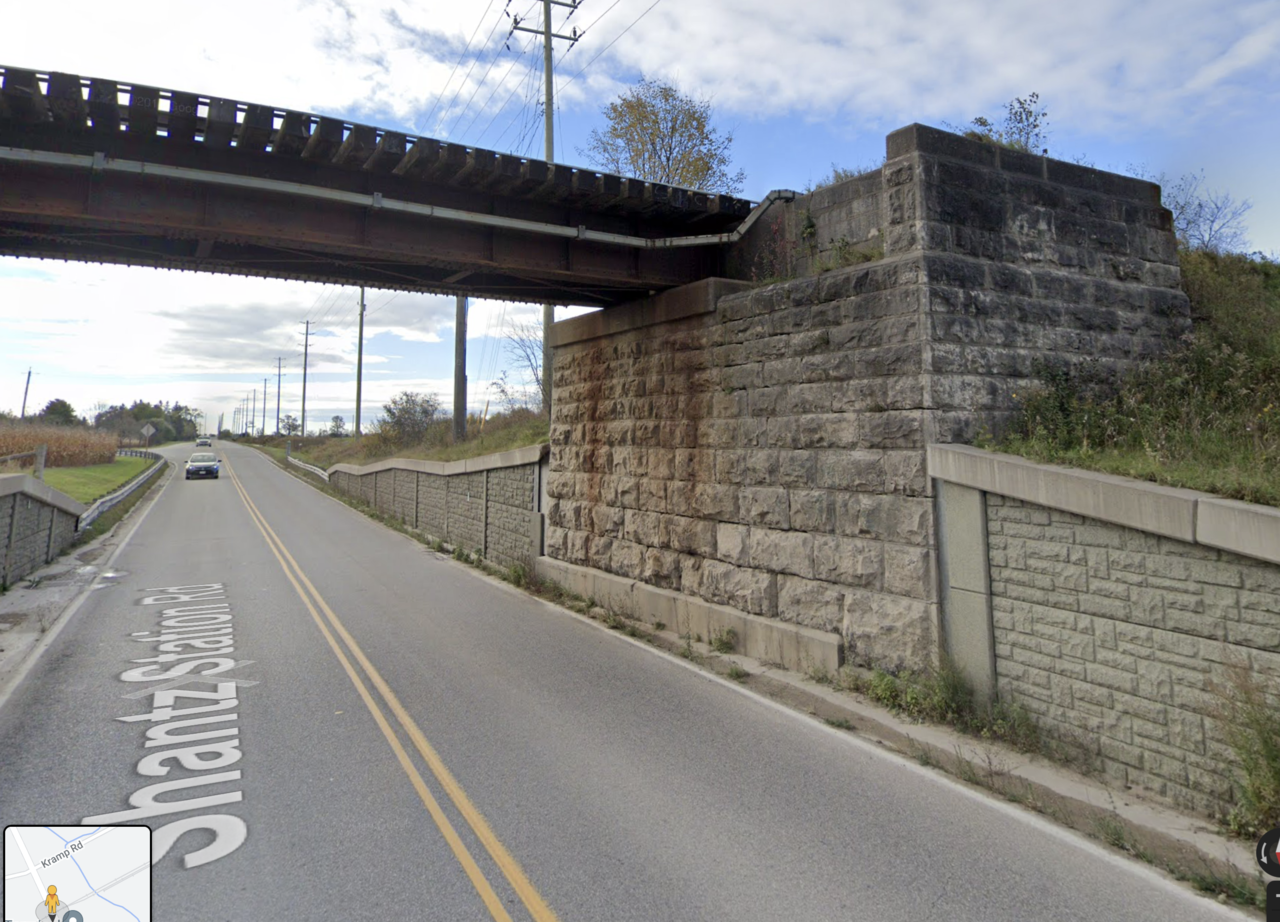

The writeup suggests that this siding will be extended eastwards once the bridge at Shantz Station Road is improved. Streetview tells me that that bridge has support for a second span roughed in. So it's not a huge project to get that done. That would allow the siding - really a stretch of double track, at that length to bypass the P+H grain elevator trackage and gain length in an easterly direction. Logically, the control point for the east end would include both the lead to P+H and the merging of the two main tracks.

Looks as though that 100+ year old bridge at Shantz Station also contemplated full double tracking!
It's almost like they've hired some competent engineering support or something, rather than going for the lowest bidder!
The Grand Trunk – nearly 170 years old – was designed for double tracking from the start. Many bridge piers are built like that.
