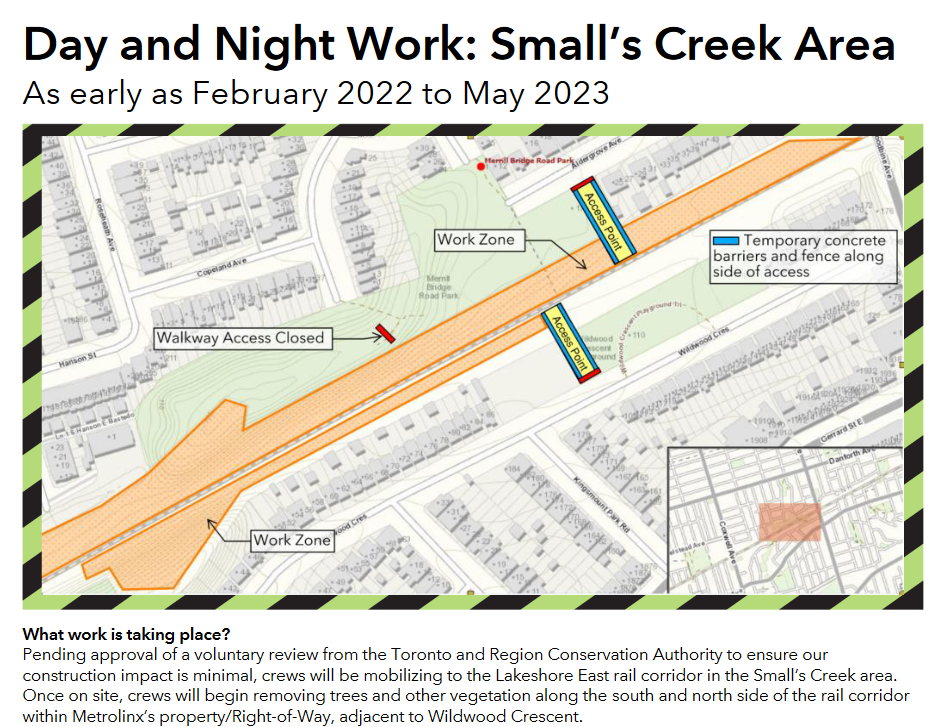

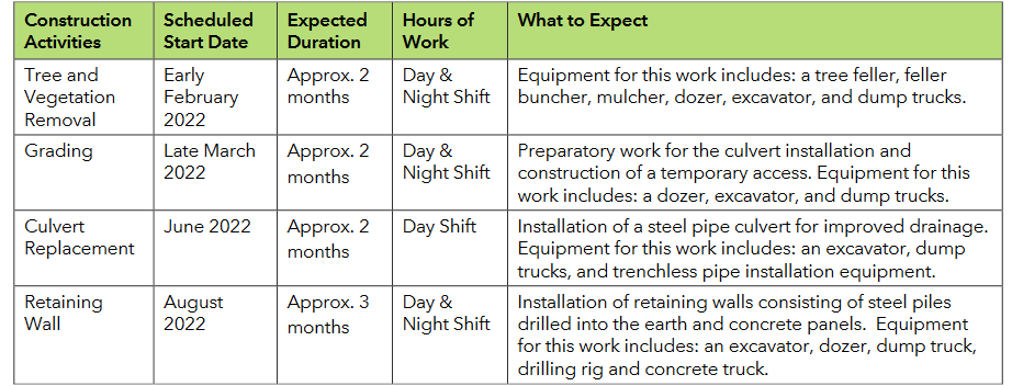

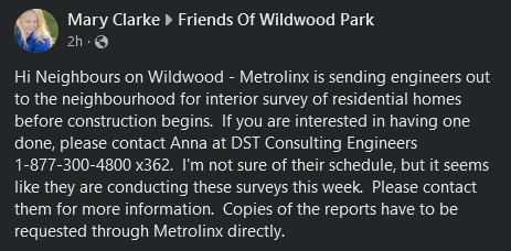

Some tidbits on the LSE Expansion project in the Woodbine - Coxwell stretch (includes Smalls Creek)

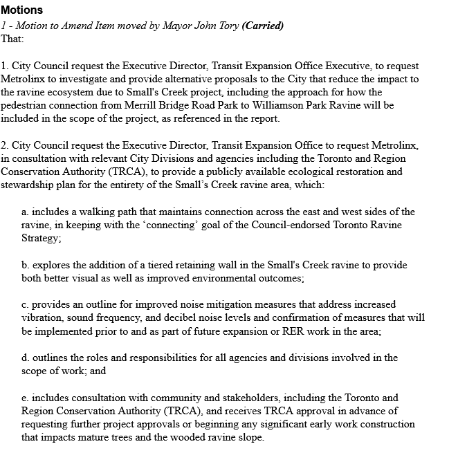

The update on Mx GO Expansion projects that was on the Executive Ctte agenda for today saw an amendment pass:

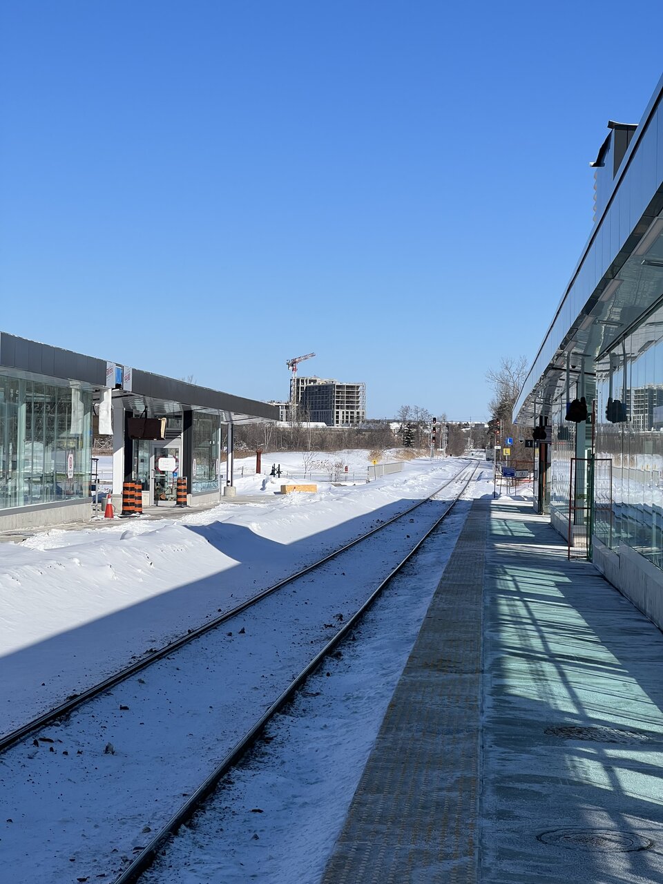

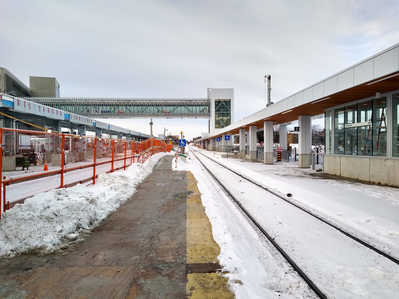

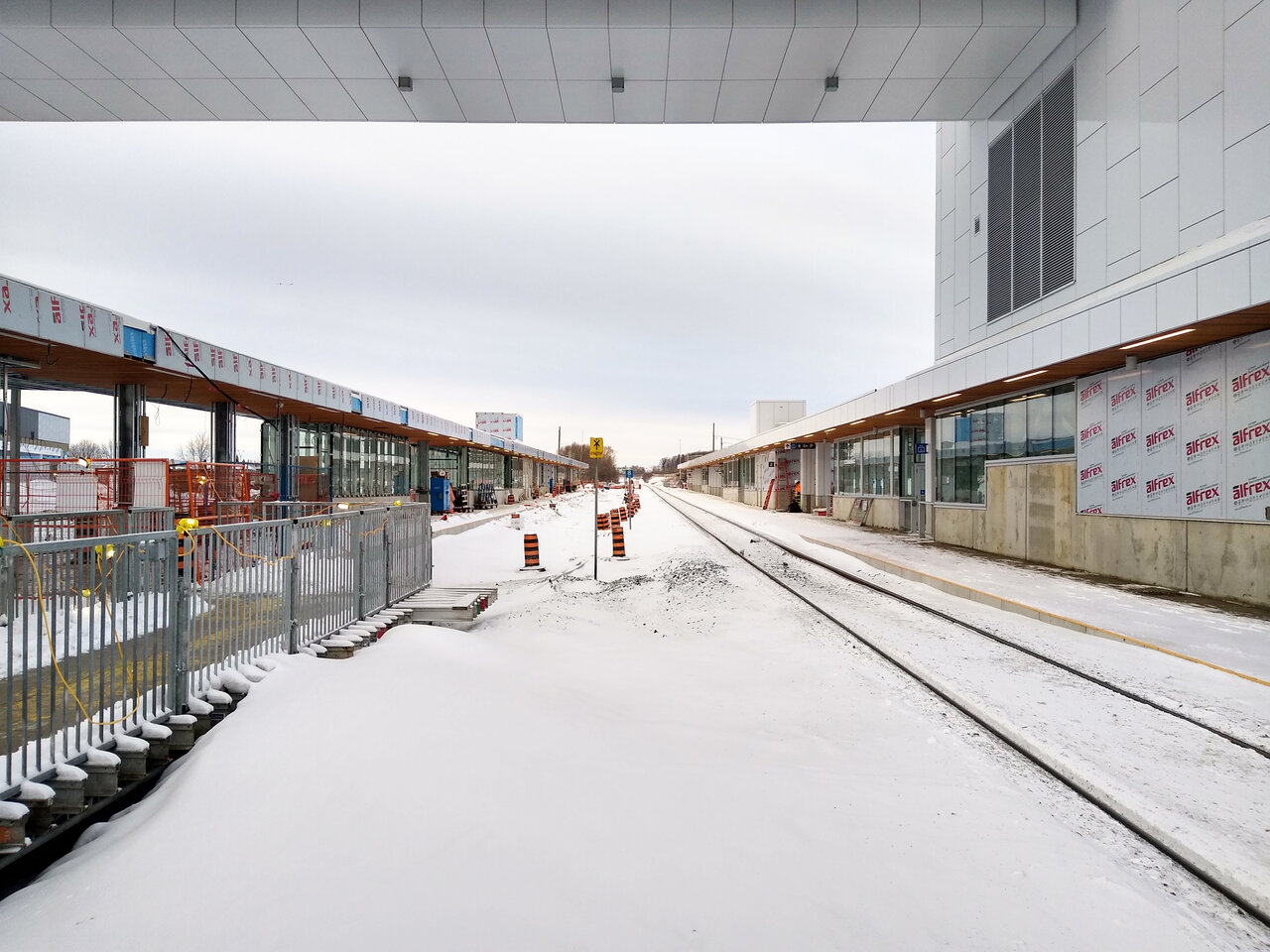

The temporary platform is still in use, but the east platform appears complete and the west platform is progressing nicely.
Looking northbound from temporary platform, note the extra-tall concrete bases on the columns to enable the platform height to be raised to 610mm for level boarding.

This angle clearly shows how space is reserved for a future centre express track. I suspect that the three bumps on the underside of the pedestrian bridge are mounting points for overhead electrification. Also note how the elevator shafts for the pedestrian tunnel are extra-tall to future-proof for level boarding.

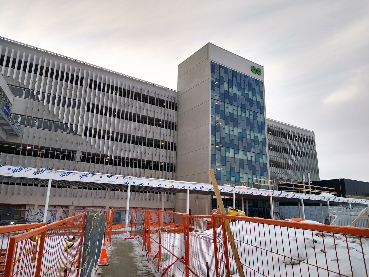

The landscaping between the platforms and the building is still under construction...

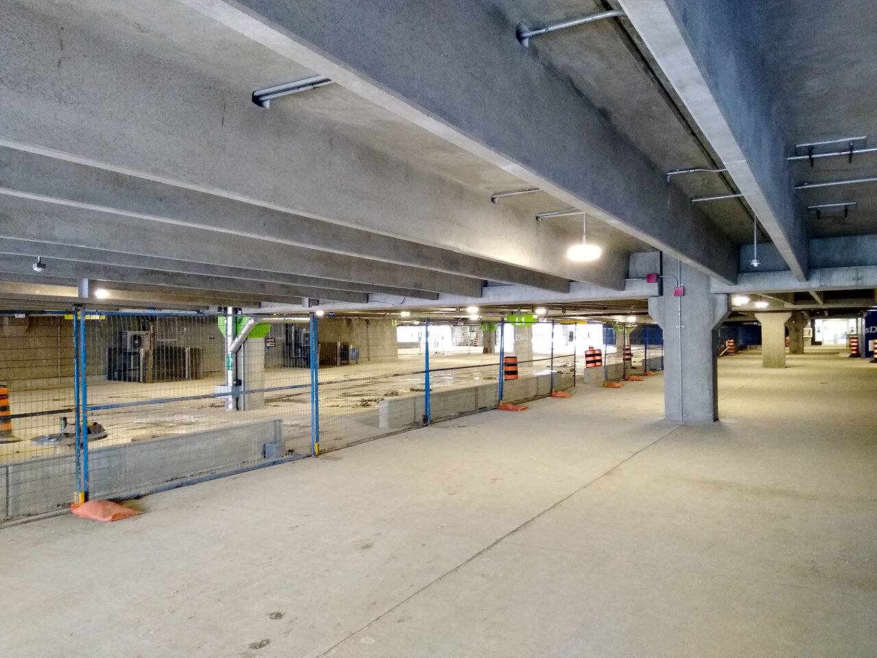

... so the pedestrian route to the waiting room and bus terminal passes through the parking garage instead.

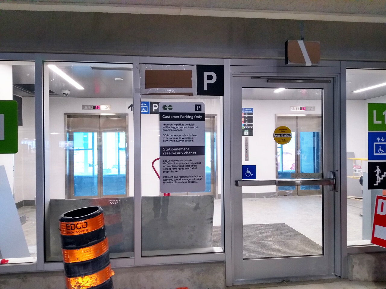

Here are the garage's 3 elevators (and staircase). The elevator sign shows an icon for "trains" on level 1, but fails to mention that you actually need to go to level 4 to access the bridge to the east (northbound) platform. If you're here, I suppose you could walk to the pedestrian tunnel instead, but I certainly hope that the other floors of the garage direct people to Level 4 for northbound trains.

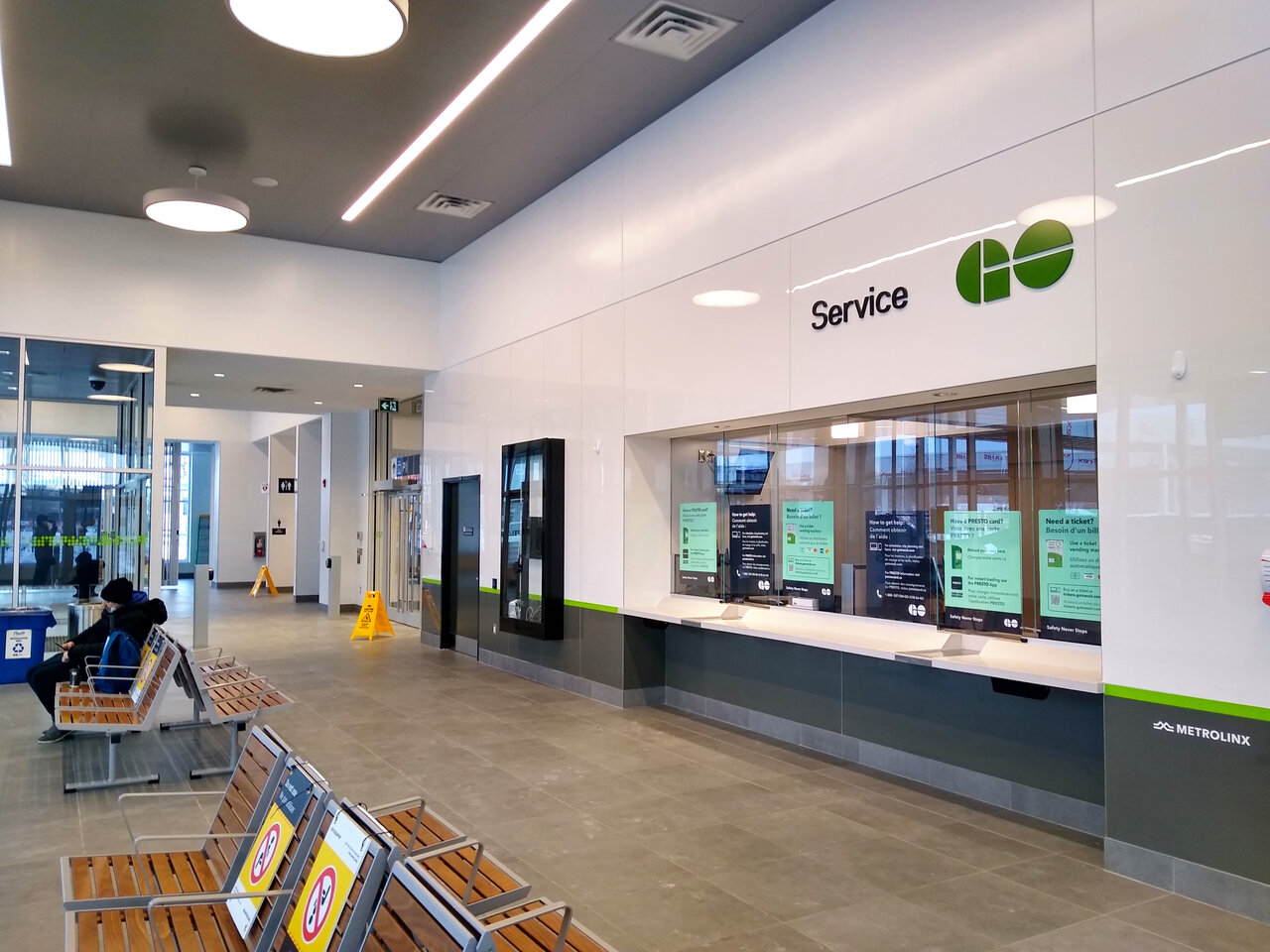

The new waiting room and ticket office is in service. Bright, clean and attractive, but nothing particularly interesting about it.

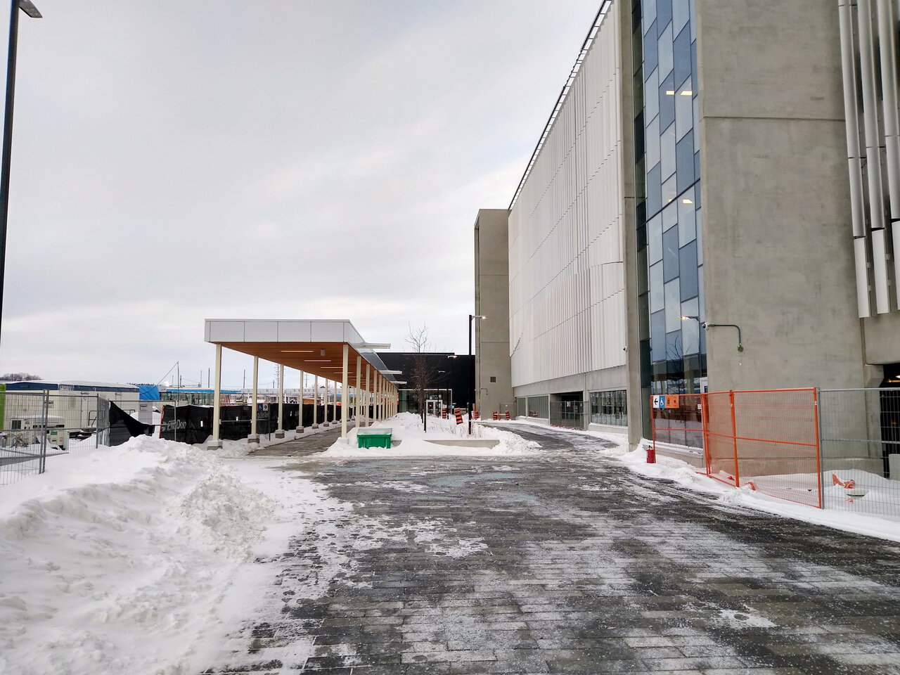

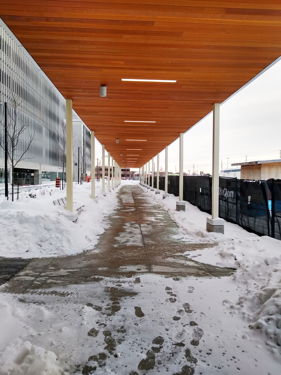

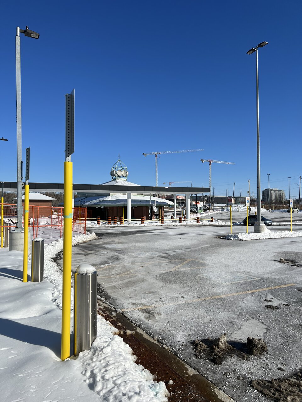

The site is crossed by these canopies with attractive wood trim. They will make it possible to transfer from a GO train to a YRT bus without ever being exposed to precipitation. This is a massive improvement in customer experience compared to previous station designs where passengers would get soaked (or faff around with an umbrella) between the bus and the shelter on the platform, and between the shelter and the train. TTC stations have always been designed with canopies, and it's great that Metrolinx is finally following suit.

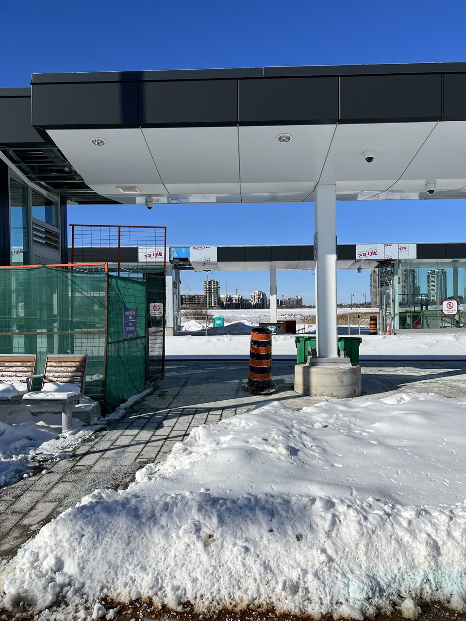

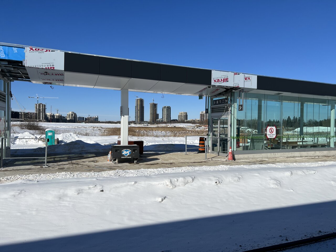

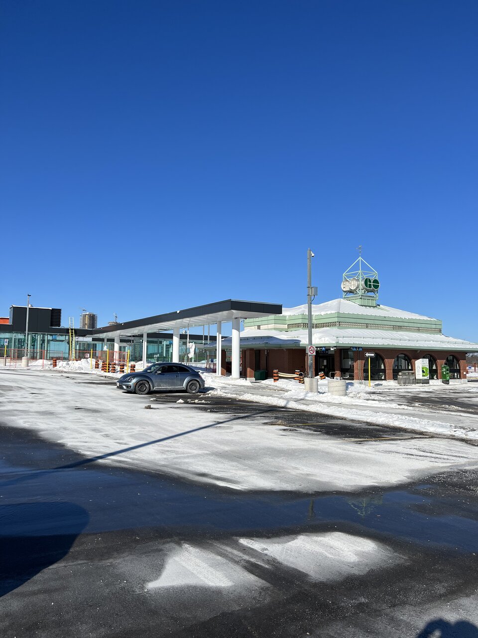

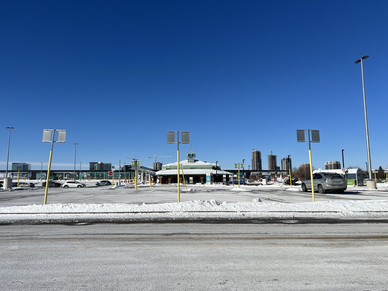

A look from the front of the station. The bus bays will be where the black hoarding is on the left of the canopy. There is currently a temporary bus terminal in the parking lot.

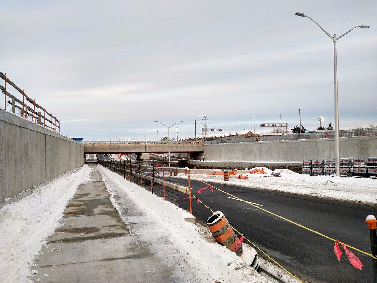

Four lanes of traffic are open along Rutherford Road through the new underpass, as well as the north sidewalk. However, that sidewalk was blocked off by "sidewalk closed please use other side" signs on both ends, even though the south side is deep inside the construction zone, and the north sidewalk is complete and meticulously cleared down to bare pavement (unlike every other sidewalk I encountered that day).
