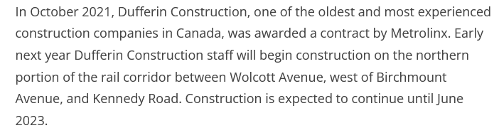

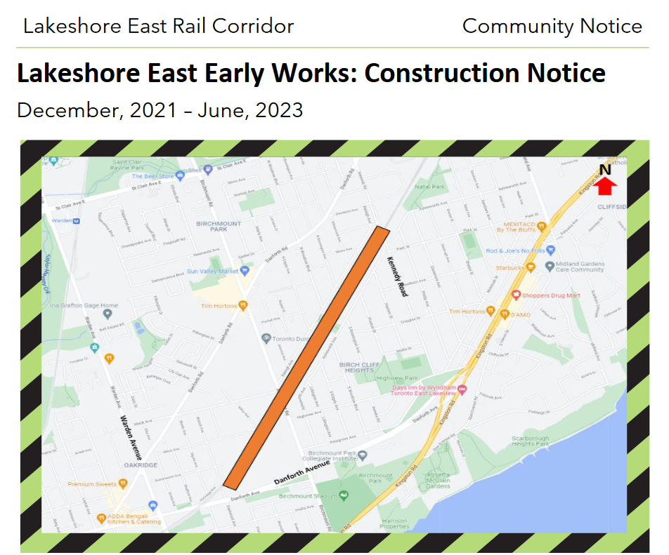

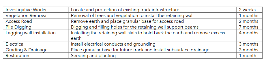

So the track would be added at a future date? Is this part of the ProjectCo OnCorr work?
I don't know for sure; but that's certainly the way it sounds; this work appears to do vegetation control, retaining all construction, conduits and track bed construction.
At the very least, the 4th track is left to a future contract from someone.
the way i understand the oncorr construction in relation to the early-works like the stouville corridor early works is that just the track bed is being installed. the oncorr contract will do the tracks
That seems to be the case. Makes sense in that it relieves the oncorr bidders of the complexity (and risk) of all the civil preparation activity…. geotechnical, hydrological, environmental assessment and design…and basic civil construction.. Plus, ML retains the public interface for the major impacts and inevitable concerns.
Opens up the civil work to local contractors who may not have railway construction expertise, making the bid process more competitive.
A bit like getting new a new kitchen or bathroom….. the framing contractor delivers a set of clean, square walls with the underlying utilities roughed in, and then the cabinet designer/installer shows up. to put in the fixtures.
