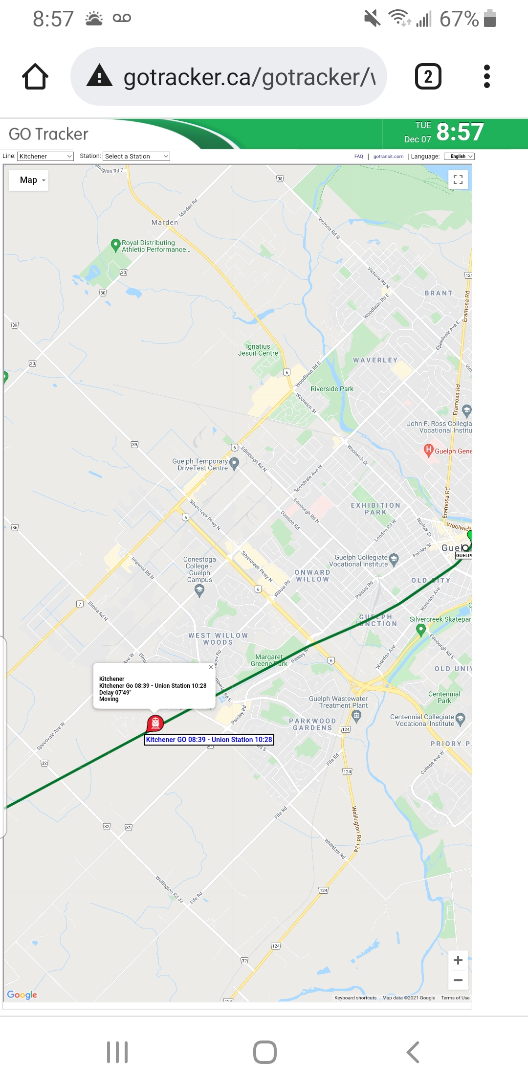

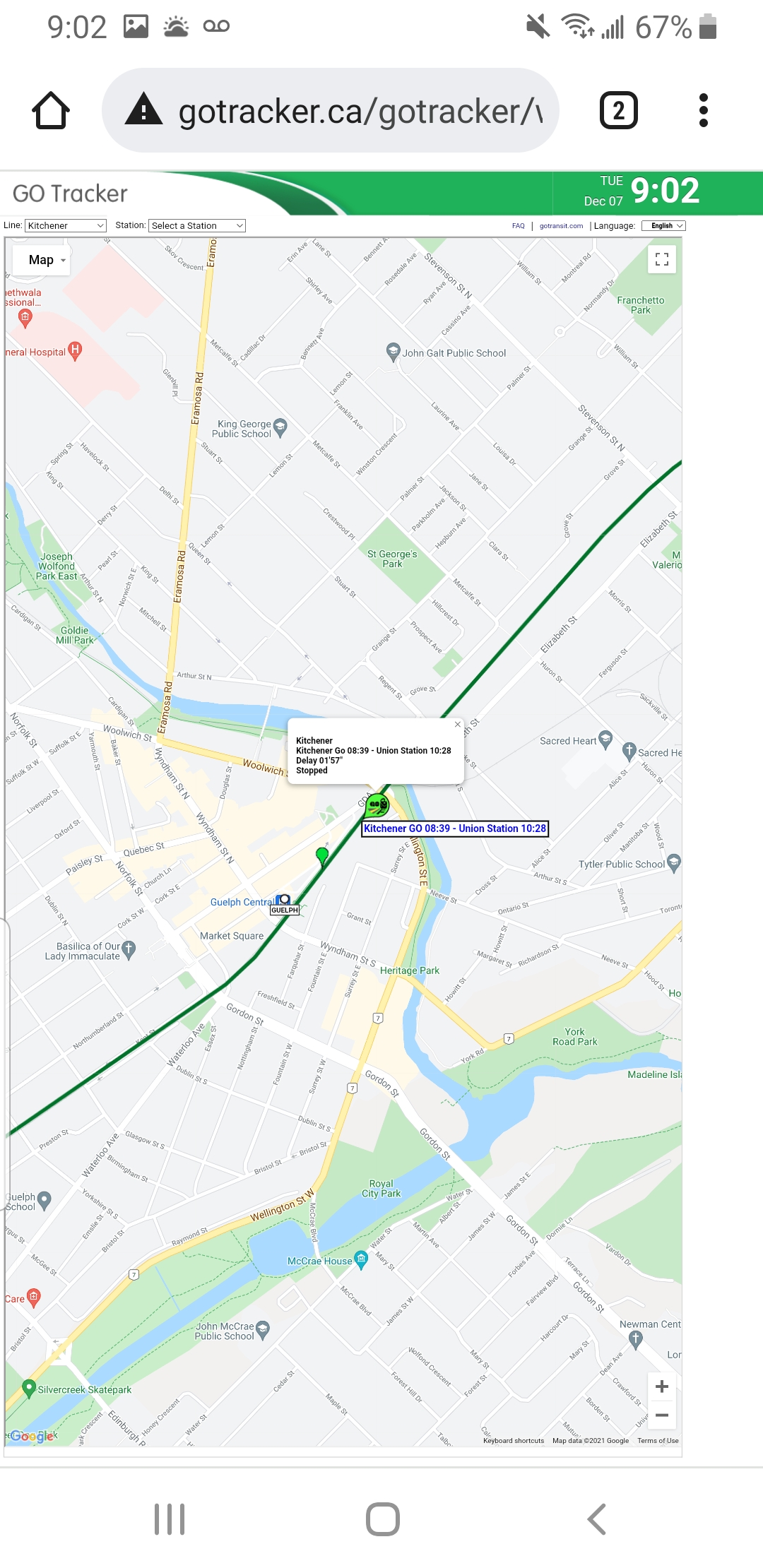

Today the 8:39-10:28 Kitchener- Toronto train left kitchener about 8 minutes late. After Guelph it was delayed only 2 minutes.
That's a good way to measure it, with a late train. So the 21 minutes scheduled time could become 15 minutes. Maybe 16 for padding. Can't drive that fast (until they build the new expressway).
Gosh, if they removed the other slow orders, and switched to EMUs with better acceleration, maybe they could get it down to 12!

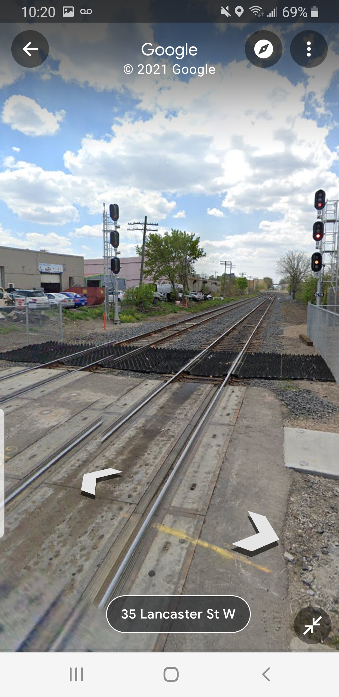

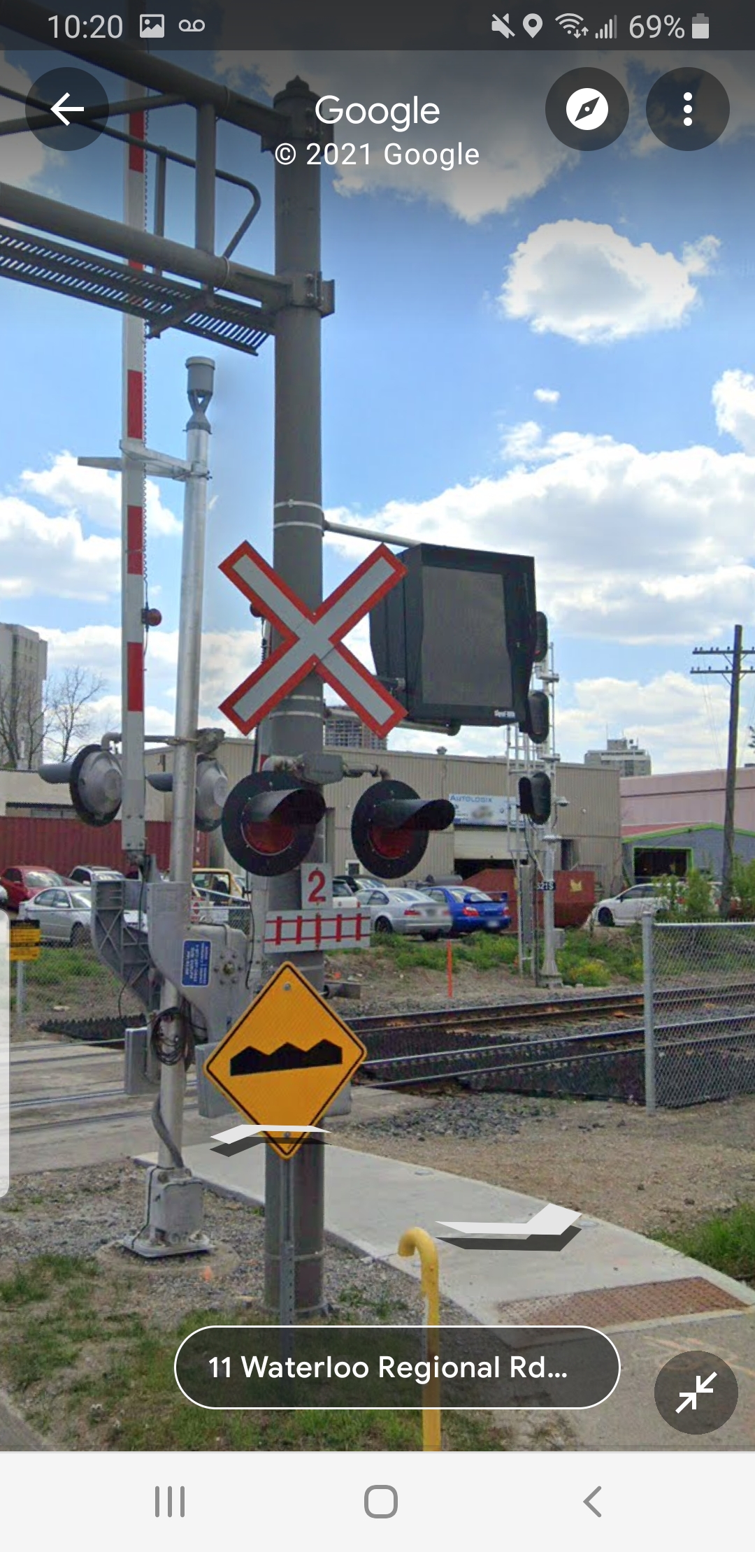

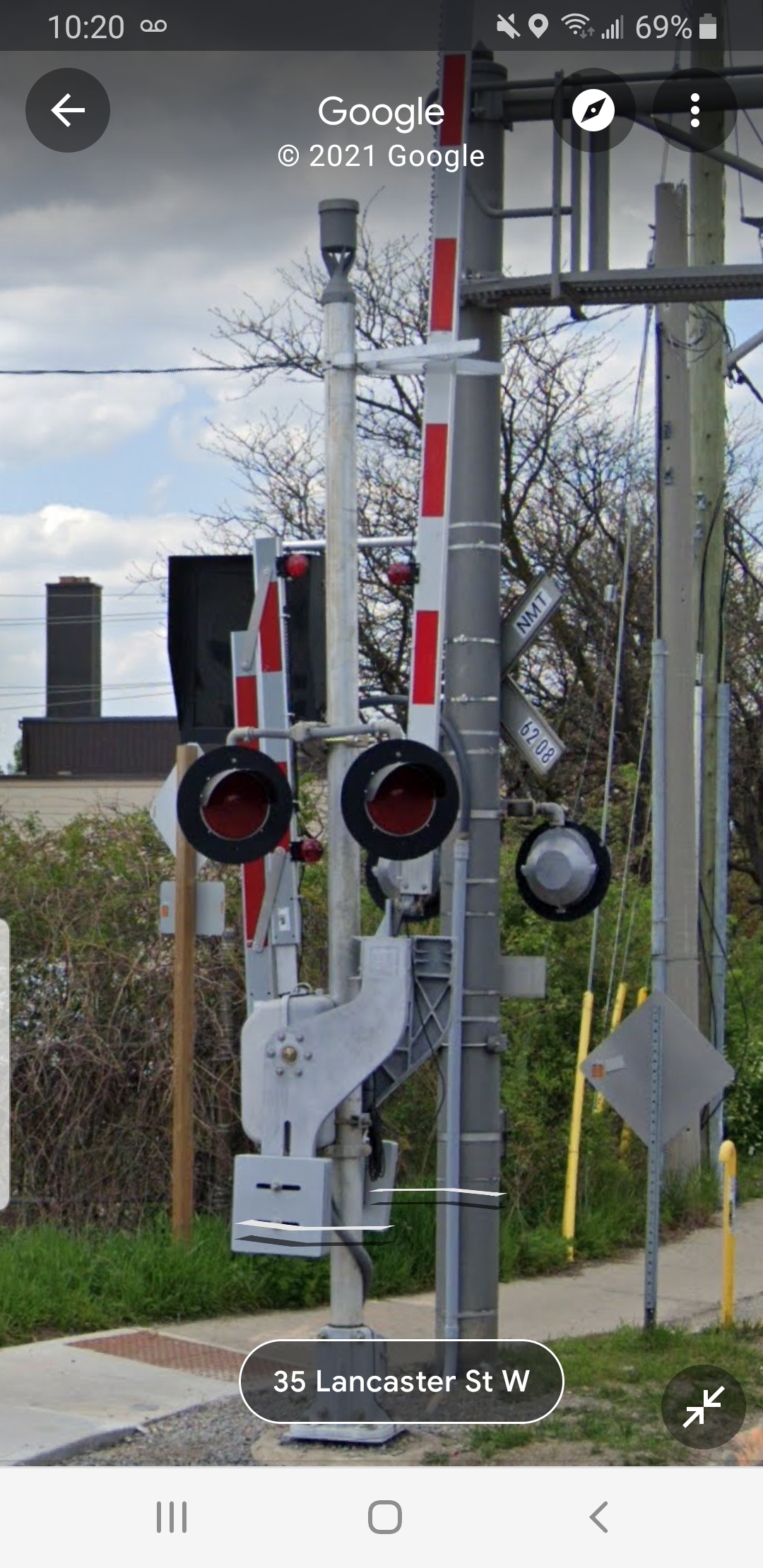

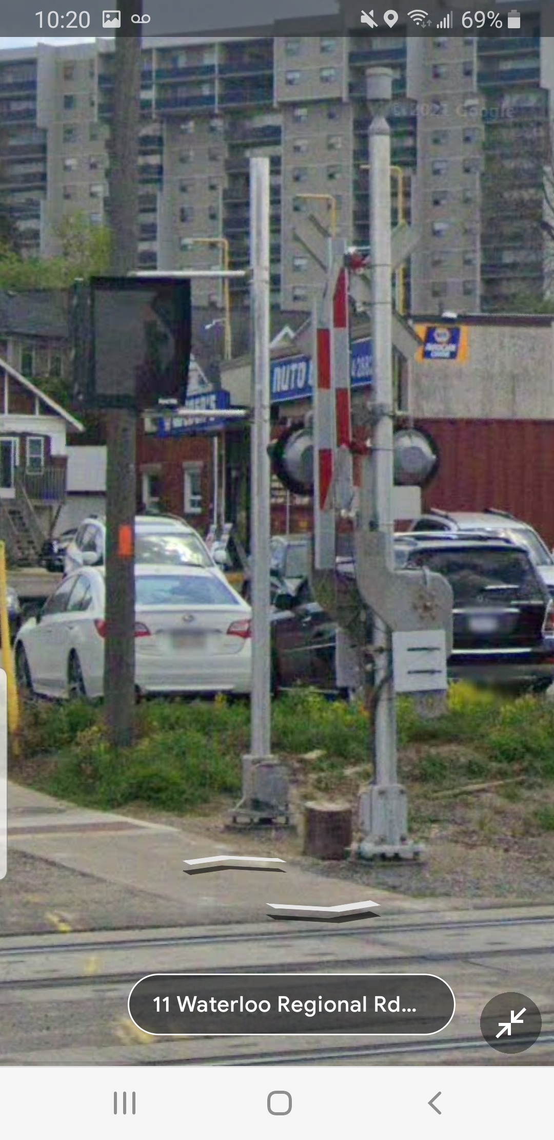

Too bad about the Lancaster slow order, they have electronic signs saying not to cross. Anti trespass barriers, crossing gates for pedestrians, yet people still trespass there
