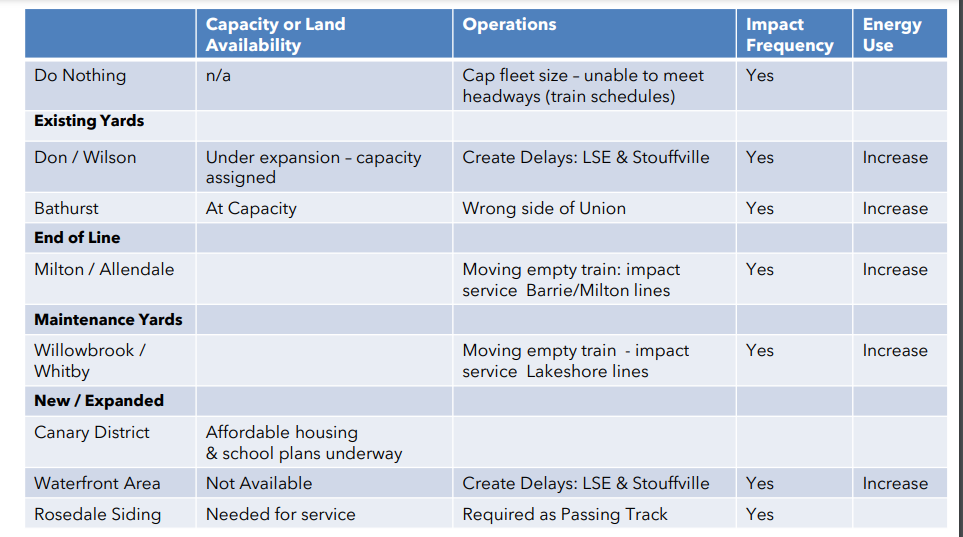

Metrolinx noted in a June 2021 presentation why the Don Valley Layover is needed.
^The intrusive part of the yard is not the choice of motive power - if diesels, they would be shut down while laying over, and if electric, there is still the OCS intrusion.
The intrusion is the addition of service buildings and roadway where it doesn't exist at present. That infrastructure makes it more than just a parking spot for trains.
Personally, I think it's an unnecessary choice at the expense of the greenery of the valley - there is likely room to squeeze three trainlengths of storage just up the road at Leaside - but the trackage needs to be retained against possibly VIA HFR and possibly a rethink of the Richmond Hill line (which will be an exercise in NIMBYism if it ever happens). The rail row should not be surrendered to parkland, and there will always be the necessary separation of trail and rails.
