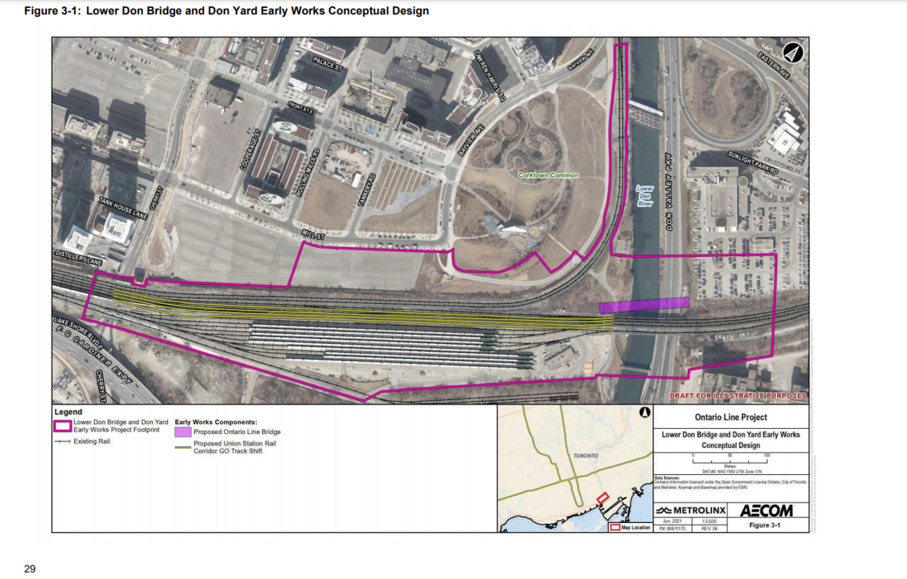

I don't think this has been posted yet here. There will be small shift of the tracks to accommodate the OL here. I assume this wouldn't impact the speed limits for GO/VIA? cc @crs1026 @smallspy
Source: https://www.metrolinxengage.com/en/...er-don-bridge-and-don-yard-early-works-report
