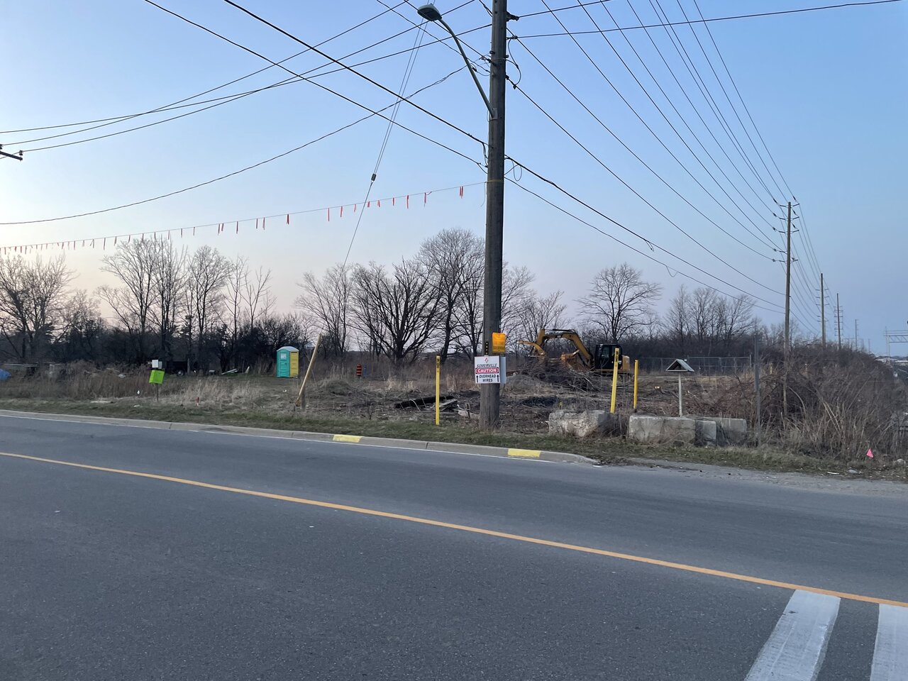

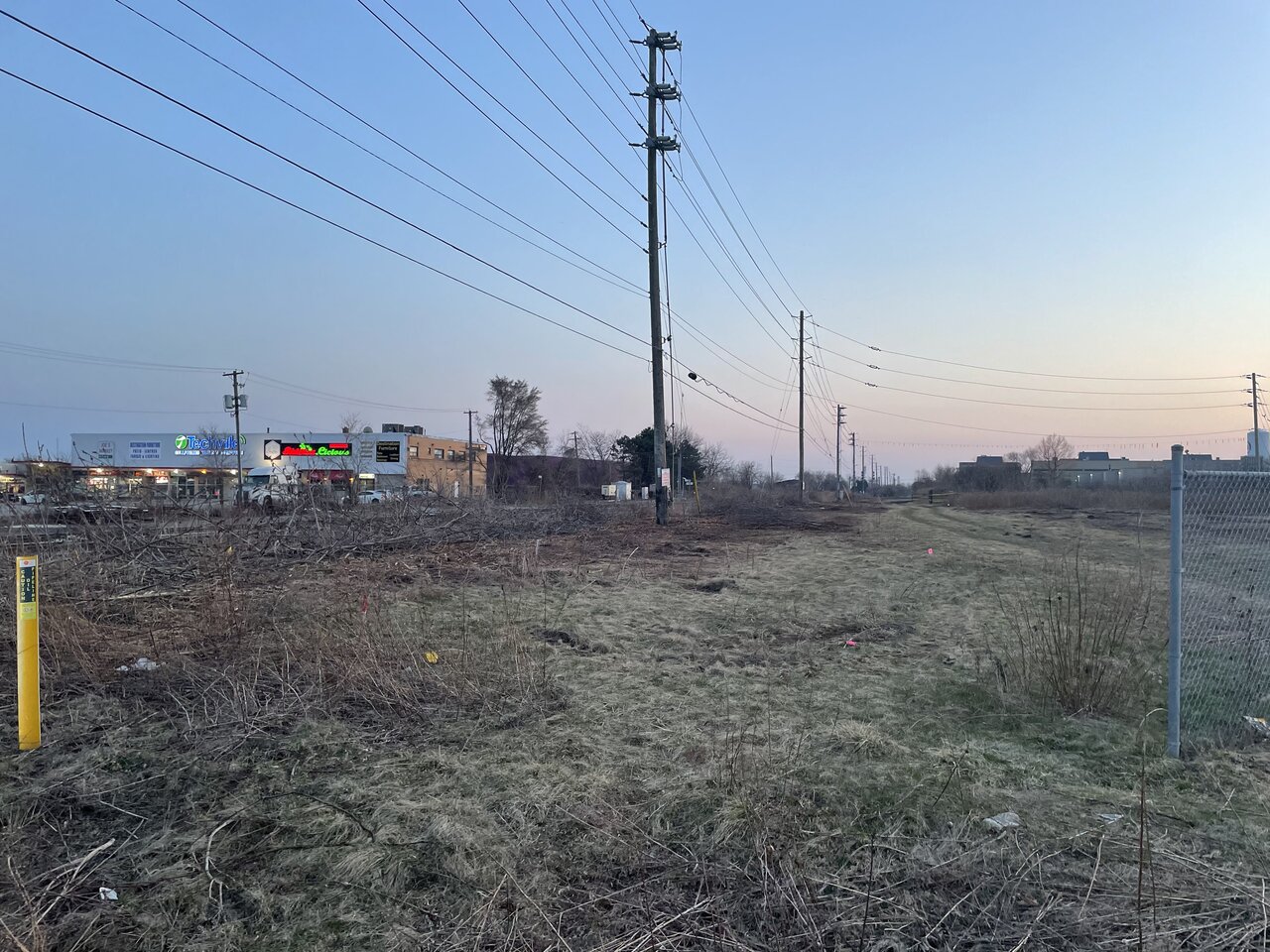

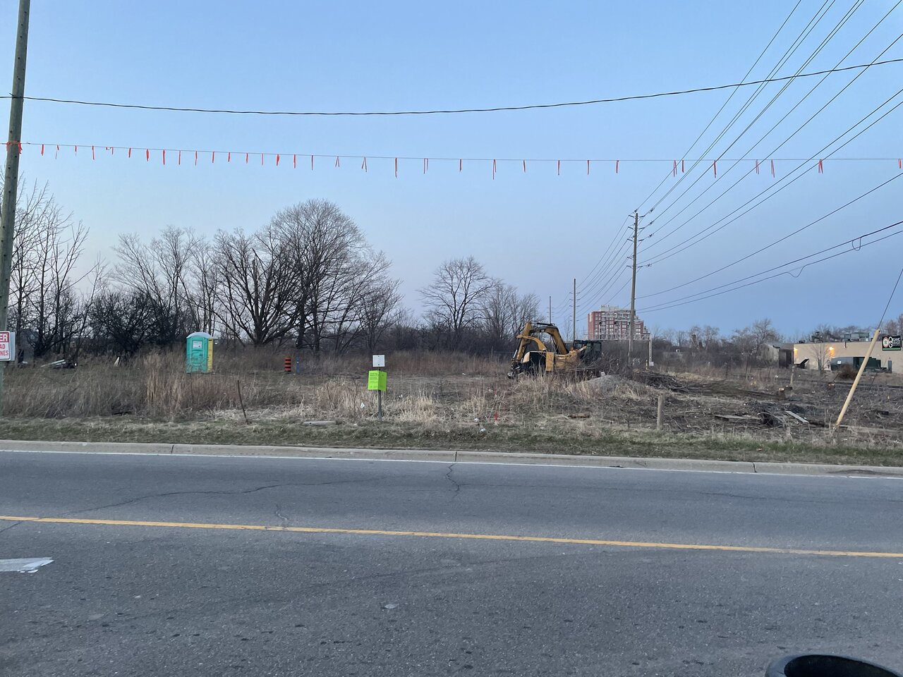

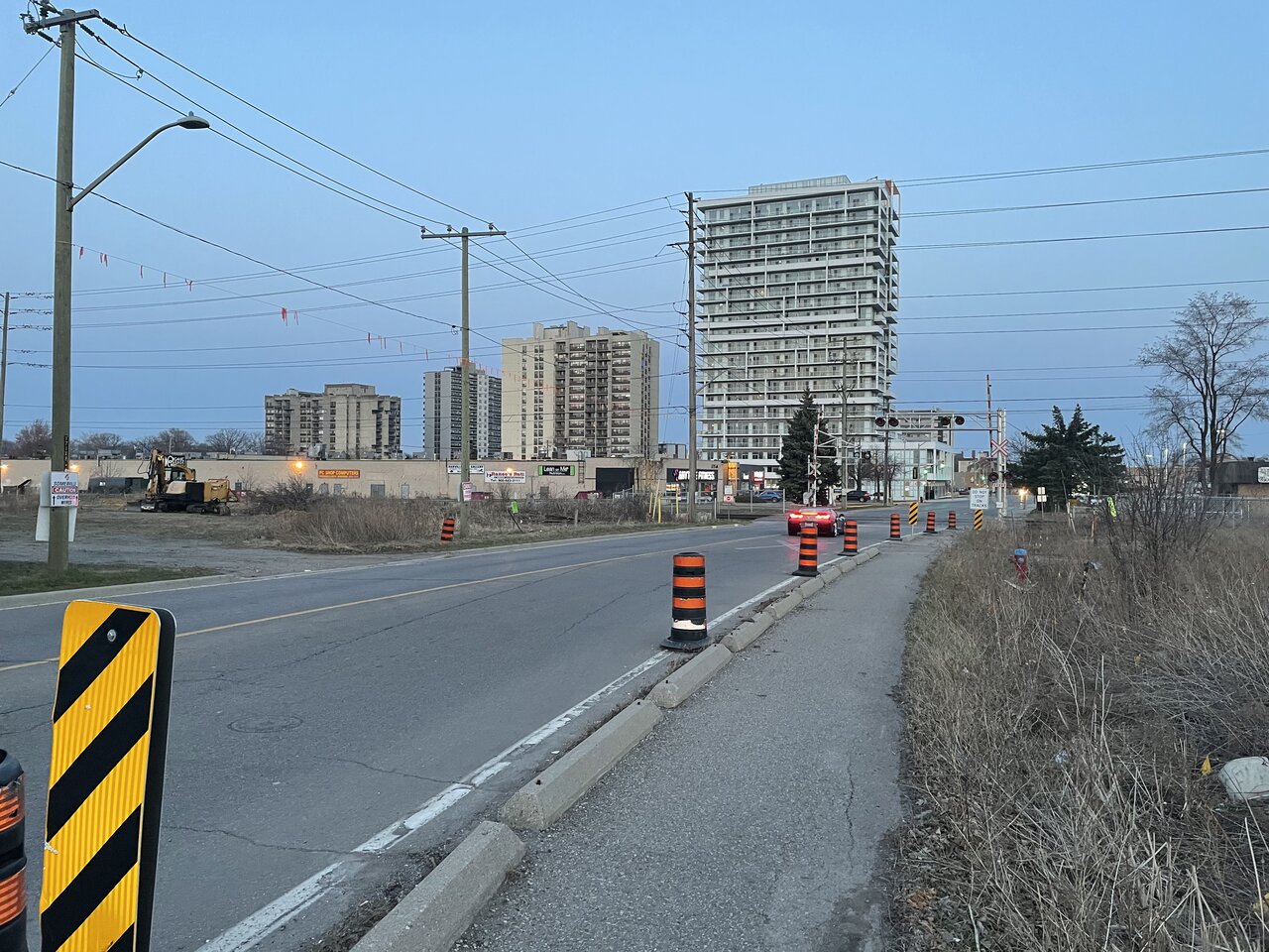

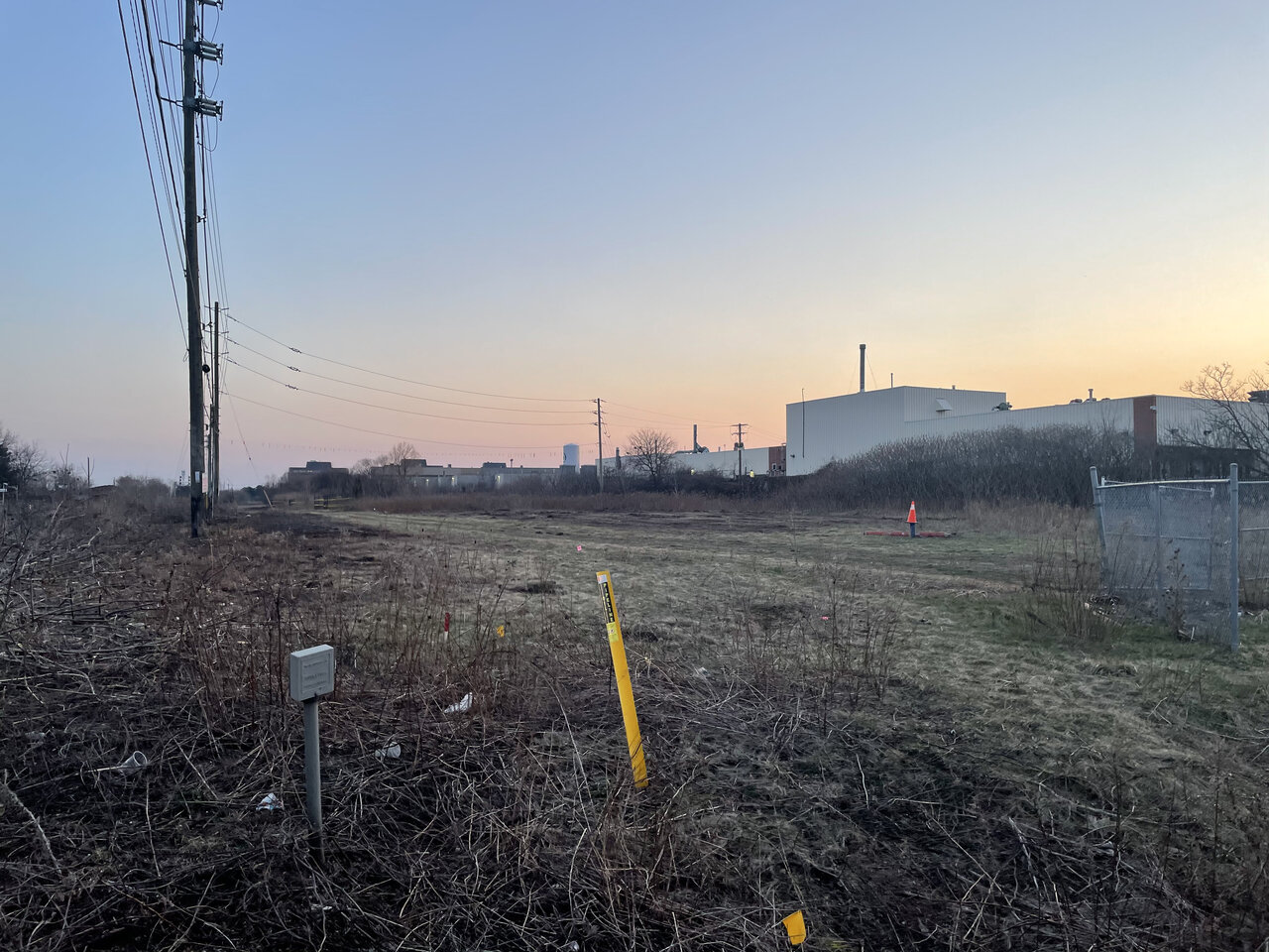

Early works underway for the Kerr Street Grade Separation (Oakville). Mainly tree clearing for now. Some roadworks too at Kerr and Speers.
As long as the construction doesn't impact sixteen mile creek and is next to the roadway, I can't imagine anyone showing up to complain. Tree removal is more like scrub removal there.
I shot the area years ago and there were no trees worth saving. This is too far from sixteen mile creek to worry about and on the west side of Kerr St.
There will be slow orders for trains until the bridge piers are in place as well the forming of the bridge over the tracks.

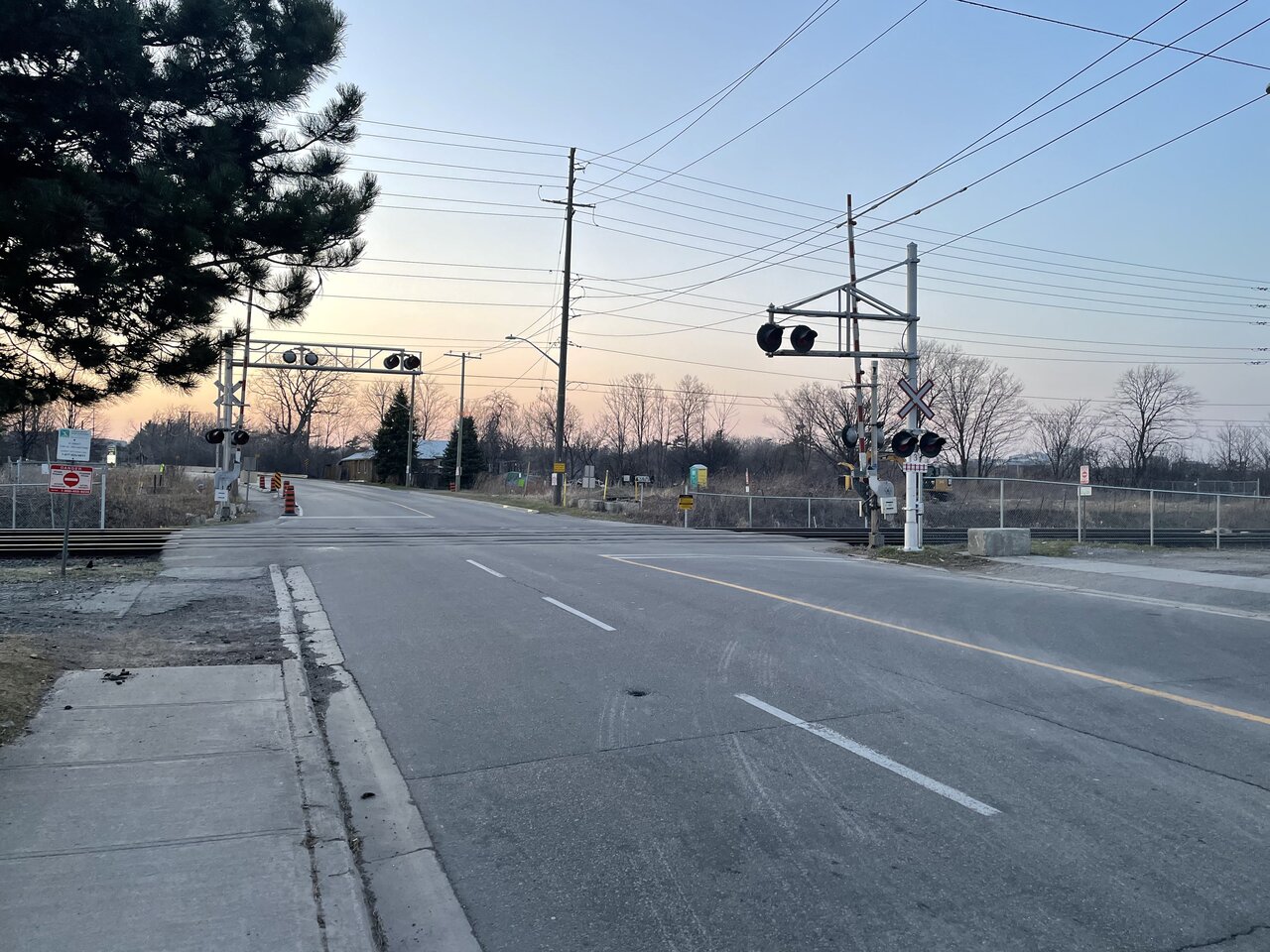

I thought this was going to be an underpass, with Kerr diving under the tracks. Last report I saw had construction doing the following:
  1. Lay temporary tracks North of the current ones (this is the area they are clearing)
  2. Re-route Kerr to the west, roughly where the Wimpy's and Good Books building is. I'm not sure when demolition will take place.
  3. Remove tracks at the current level crossing and build the underpass with new tracks overtop
  4. Re-route trains to the new tracks, keeping the westerly alignment for Kerr
  5. Complete the new sections of Kerr St
  6. Re-route Kerr to the new alignment and remove the temporary level crossing

The last I heard and saw it was to be an overpass, but haven't follow it in years. The Rain Condos sidewalks at Sheppard were move to the south for better access to Kerr St

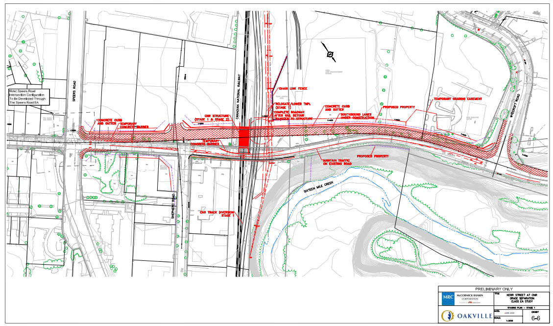

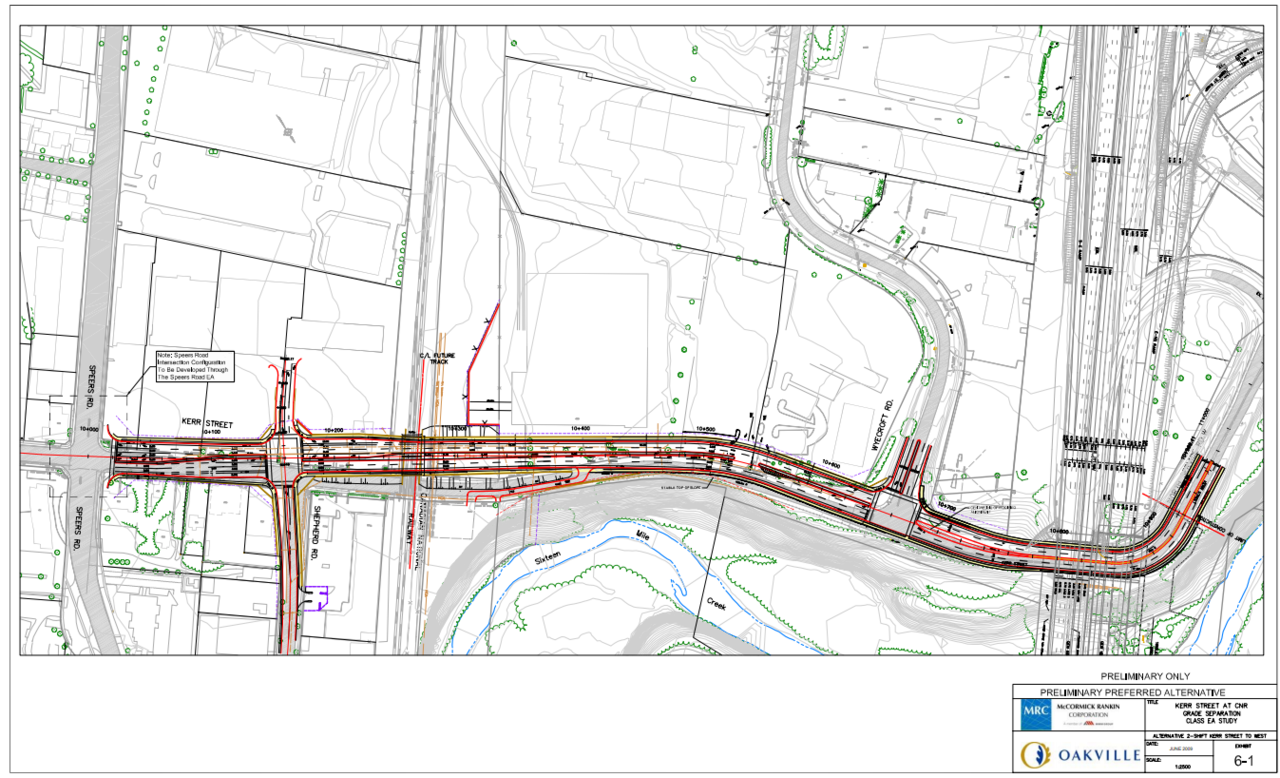

Looks like it will be an underpass, but I was wrong about road alignment. The new road is to the west, with the current road alignment being used during construction. https://www.oakville.ca/residents/rs-studies-kerr-cnr-crossing.html
Preferred Final alignment:
Construction Alignment:
Looks like ML had a hand in the change as eliminate the need for the barrier that needs to be place on the ramp and bridge for the overhead system as well increase the height of the bridge. The slope on the south side would have to be increase to match the new height as well the distance from Sheppard,
Sheppard was moved south to allow the new intersection when Rain was being built a few years ago..
The new alignment straightens out the road which was part of the overpass design.
