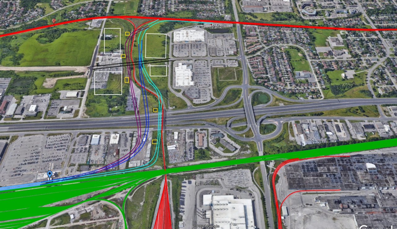

Video of the townhall. The last response to a question (in the last 5 min) provides some insight on the 401 bridge. It sounds like it will have two tracks, be to the west of the existing CP bridge, and then crossover using a diamond to head east.
This is my very rough attempt to visualize what was said in the last 5 minutes for how the GO Bowmanville Extension will cross the 401 and then cross at a diamond the CP GM spur. I'm not a civil engineer and as you can't see I only have rough paint skills. Just an informal attempt for discussion purposes. Given the talk during the townhall of providing less parking and working with developers/landowners, I wonder if the Thornton's Corners GO Station (now called Thornton's Corner's East in the IBC). One aspect I haven't considered is the description of Option 2 which says CN's Kingston Sub needs to be briefly utilized? cc @crs1026 @smallspy
As with Option 1, this alignment requires the consent and approval of track owners and other impacted parties. In this option CP as well as CN, VIA and Hydro One would have to be consulted and approvals will be required. This is due to GO’s need to operate on CP’s Belleville Subdivision and briefly utilize CN’s Kingston Subdivision east of Oshawa GO Station in order to reach the GM Spur. Agreements will also be required with VIA Rail for modifications to the existing Oshawa GO Station and Hydro One due to impacts on above ground hydro services in the vicinity of the Highway 401 crossing. Further, clearance from the new top of rail to the underside of Hydro One’s power lines will need to be confirmed to ensure adequate distance is provided.

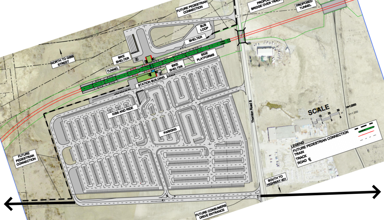

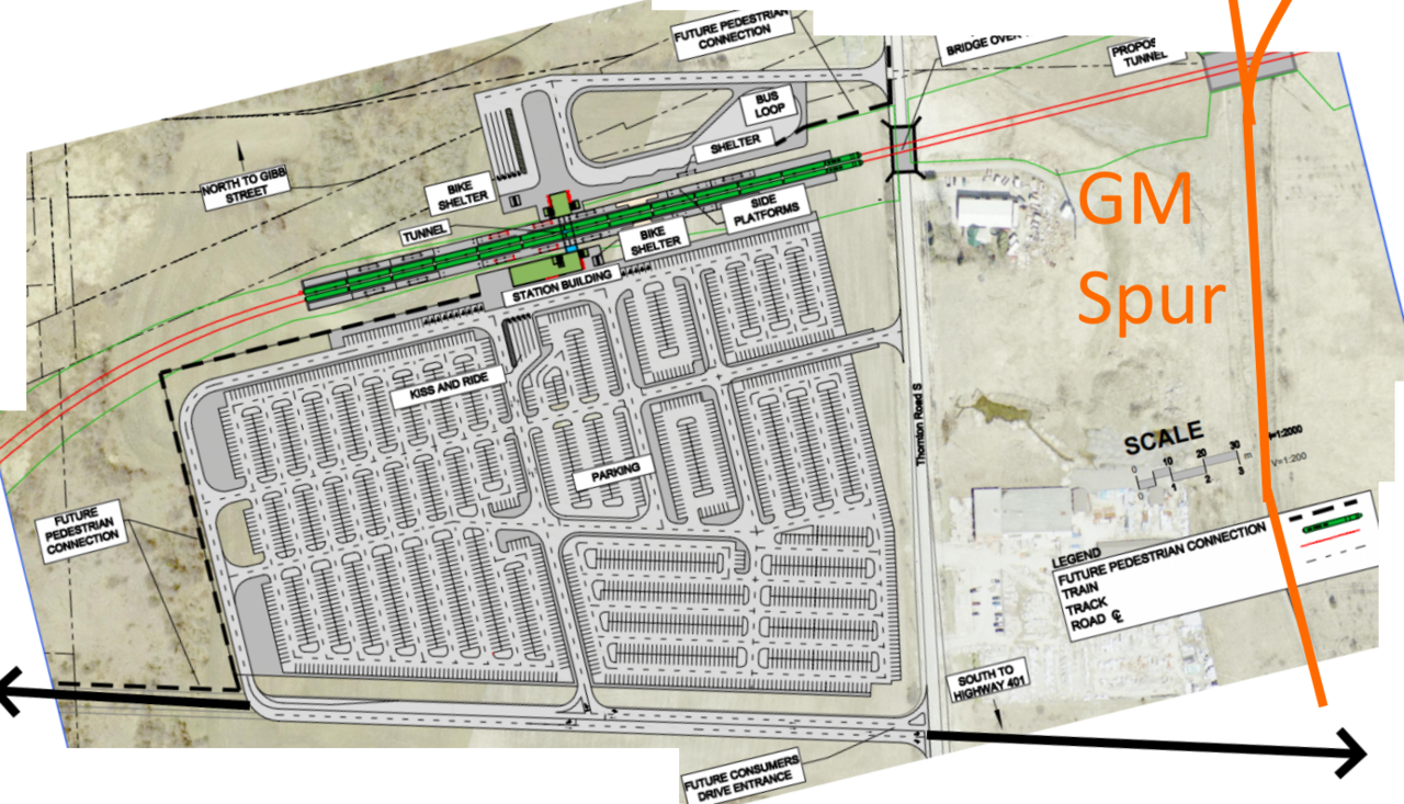

I also wonder if there will be a desire to have the Thornton's Crossing East Station to the east of the GM spur track/new GO tracks (light blue or blue). It appears if the station is on the west side, CP is worried about car traffic and people rushing to the station on the west side given this line in the IBC: "Additional grade separations are requested by CP in this area, a road-under-rail grade separation on Thornton Road South and one rail-rail separation where Metrolinx’s new track would pass under CP’s wye track to the GM plant south of Highway 401 connecting into the Belleville Subdivision." (page 63)
Legend:
Options for crossing the 401 in light blue, dark blue, and purple, hydro towers in yellow, road extension per the Official Plan on PDF page 398. White box possible station and parking lot locations.

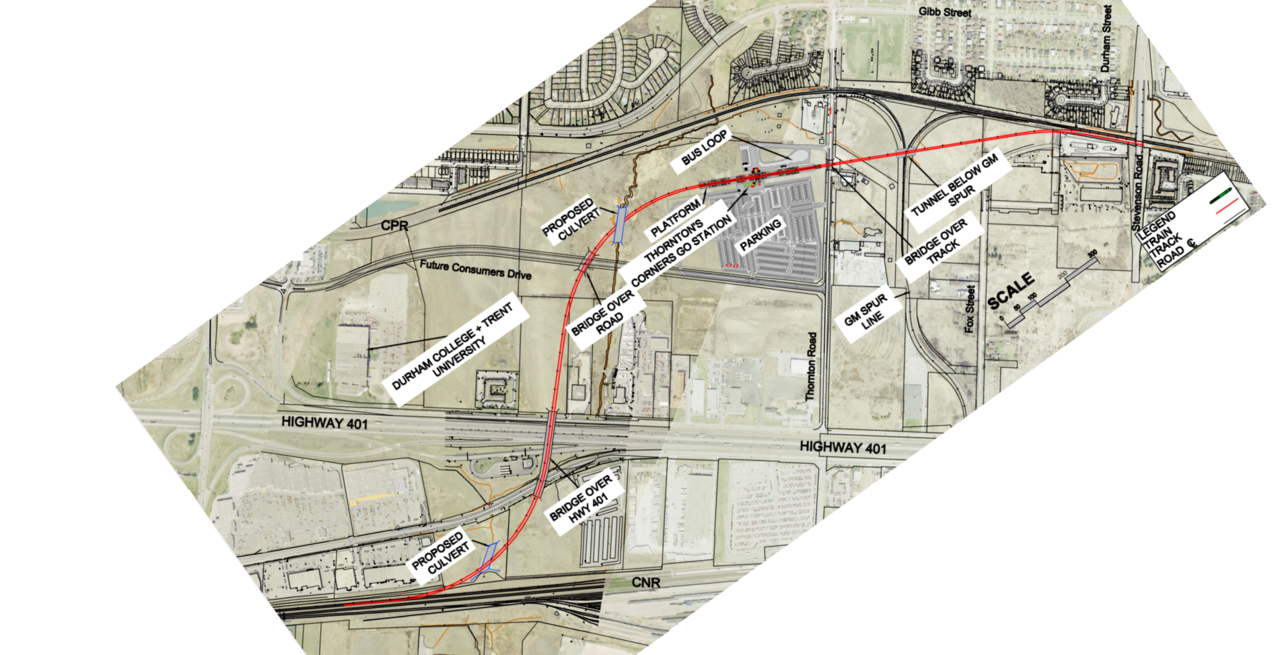

Just as a comparison for the former Thornton's Corner GO Station, here's Option 1 and the "Overview of the 2016 announced GO - CP 401 rail connection (new connecting track in red)" (page 17). There is a long description on pages 17-18 on how this option would have cause track movement conflicts with the Whitby Rail Maintenance Facility to the east. [map rotated below so that the CN/VIA line and the 401 have a similar orientation to the map above]
There isn't a detailed description for Thornton's Corners East in the IBC. Did does say on page 39: "Note that the new Thornton’s Corners East Station would not offer park and ride spaces; rather focusing on providing bus loop, cycling and Pick Up Drop Off (PPUDO) infrastructure."
I take that reference to the Kingston Sub to refer to the "sacrifice" of the northernmost VIA platform, which no longer can be reached from the platform to the north. The more CN can shift to the south, the easier that curve and gradient up over the 401 can be. Just a guess.
