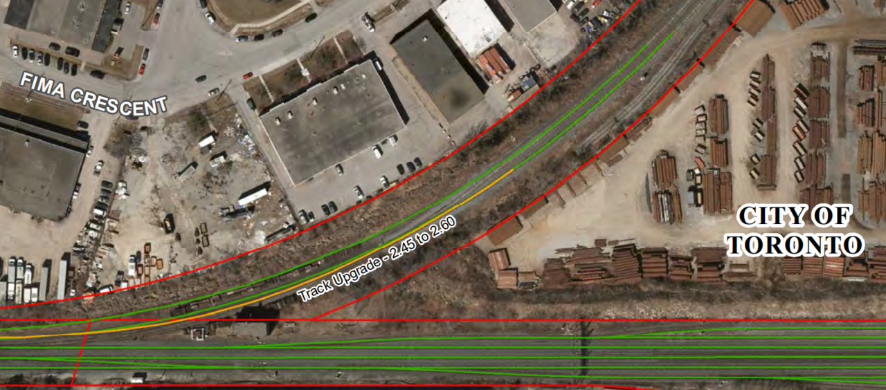

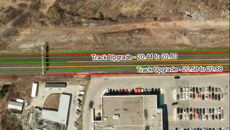

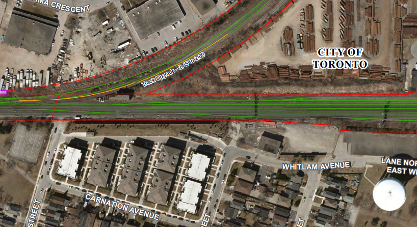

In reviewing the APPENDIX A1 - Conceptual Corridor Plans (PDF) (from here as posted above) I see a few places where it says "track upgrade". Anyone know what it means when it says things like 2.45 to 2.60 or 20.44 to 20.80? cc @smallspy @crs1026 (pictures below of LSW examples) UPDATE: never mind. I believe it's referring to the mile marker start/finish points for the upgrades/new track.
