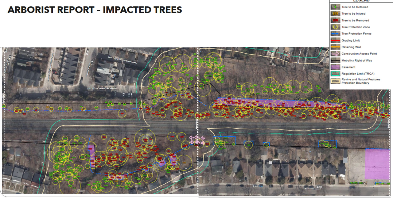

A note about the image below; the size of the circle is relative to the size/maturity of the tree in question.

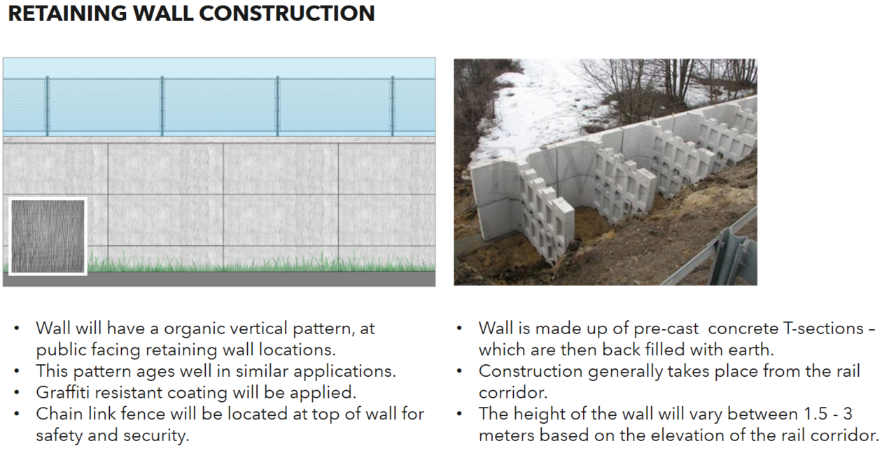

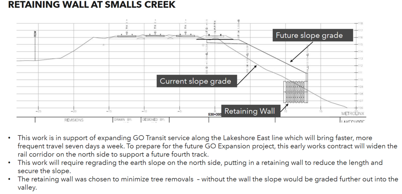

I'd swear I don't remember a retaining wall that large; that's not related to the culvert, but to regrading associated with the 4th track.
Note the culvert render.........and refer back to the Mx spokesperson suggesting this would be a usable new wildlife connection............
Gonna have to add here, at least on this side, if they're clearing that much land, the ecological disturbance of a much larger culvert would be immaterial.

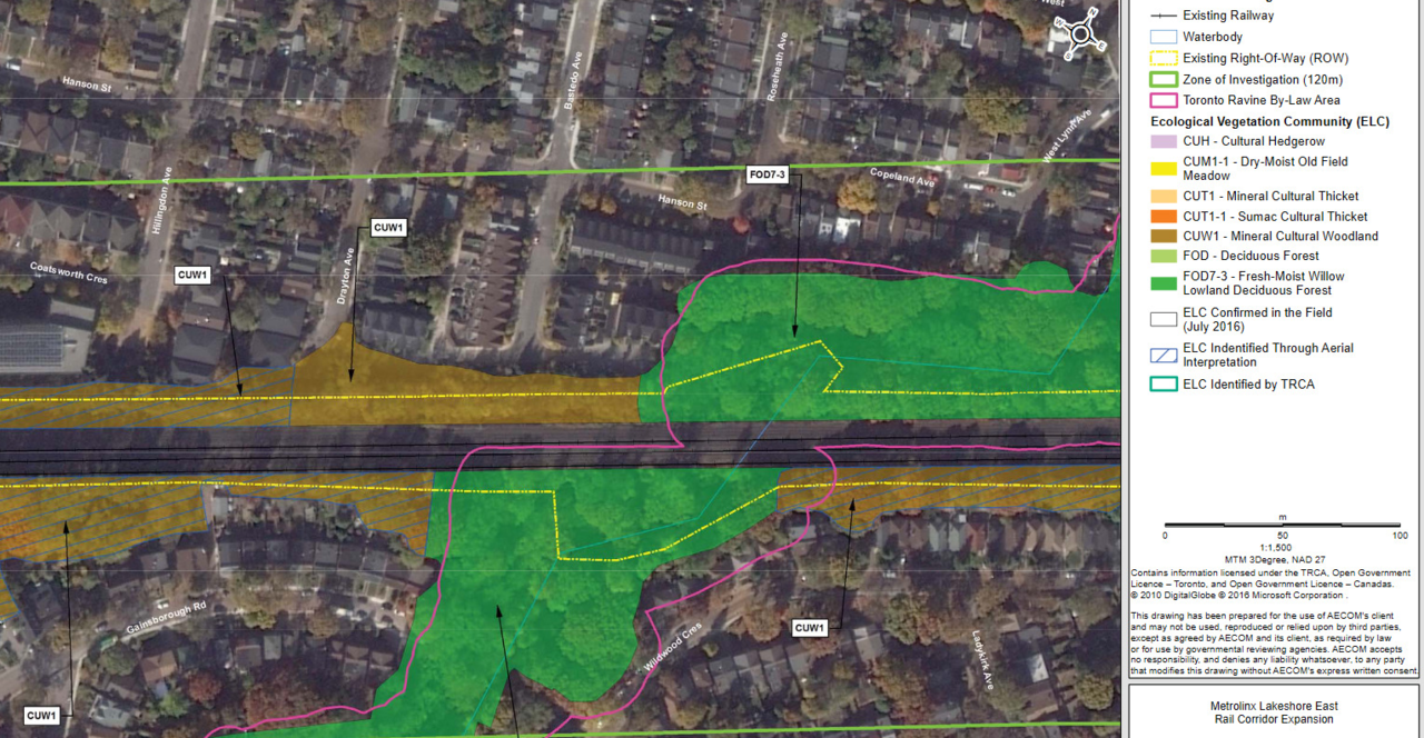

Additional documents:
Details from the above:
Based on the results of the terrestrial field investigations, the following regionally rare plants may be affected by the proposed activities: Balsam Fir, Poison Ivy, Silky Dogwood, Wild Red Current, Sycamore, American Prickly-ash and Big Bluestem. A majority of these plants occur within the Fresh –Moist Willow Lowland Deciduous Forest (FOD7-3). This vegetation community is located in the Williamson Park ESA, south of the rail ROW and extends north to Merrill Bridge Road Park (Figure 3-10 and Figure 3-11 in Appendix A).

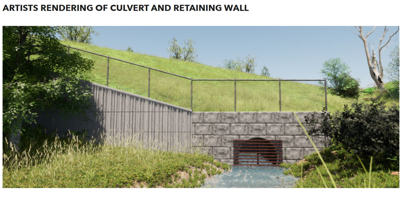

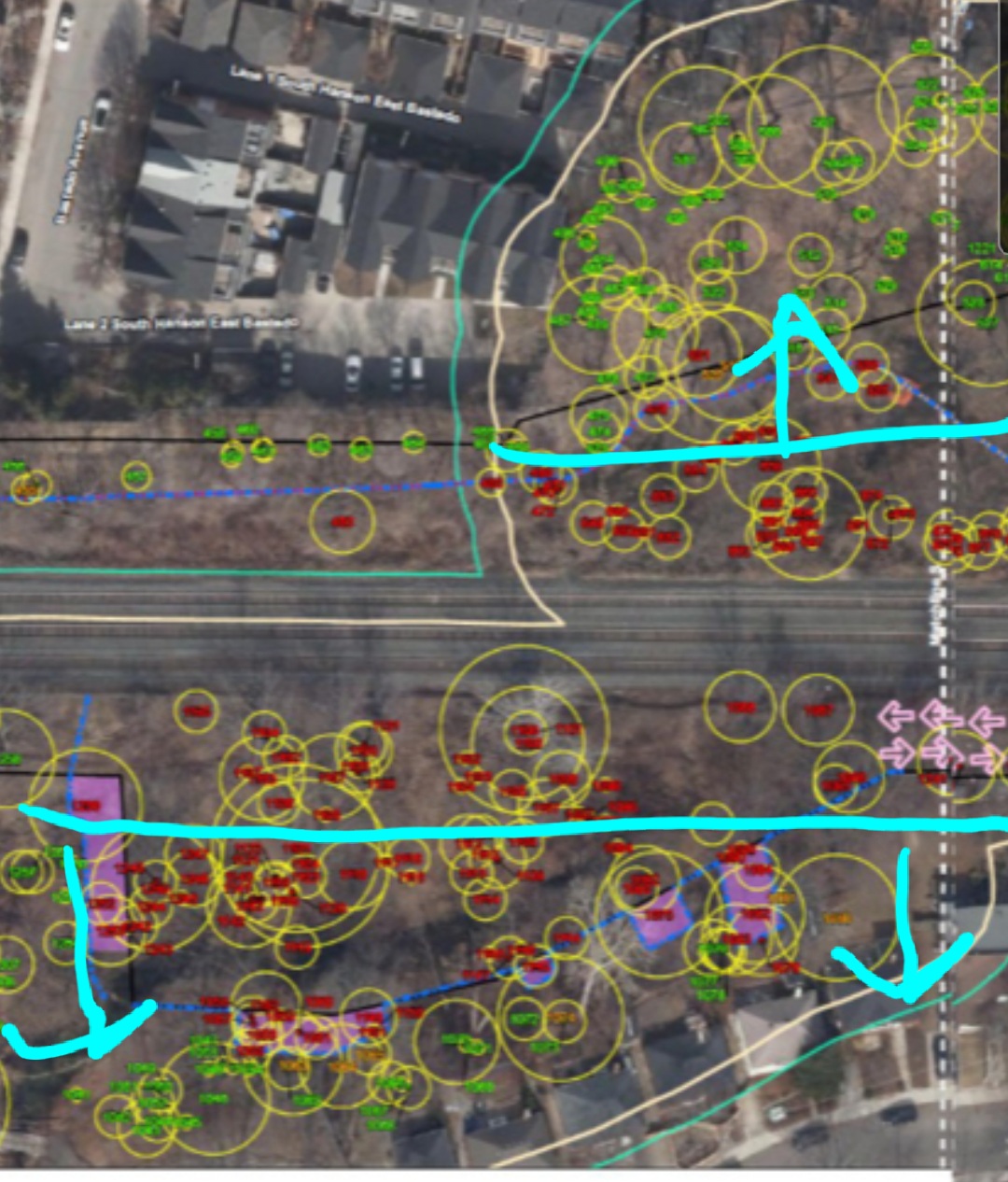

Just out of curiosity, why do so many trees (red dots) need to be removed this far (either side of the blue line) from the tracks/new track?
I wasn't consulted on the project..........but my read would be that the trees are either directly in the way of the new retaining wall, the culvert, the access space needed for construction vehicles (it can't all be done from above) or are in the way of associated re-grading.
Keep in mind that trees have branches, and roots that spread considerable distance. In general, {over-simplified) tree roots spread as wide as does the crown of the tree.
If the roots are in the way of the re-grading, the tree would likely die from having a substantial portion of those roots severed.
Less an issue w/branches, but a massive cut into a tree would would injure it and might overwhelm it.

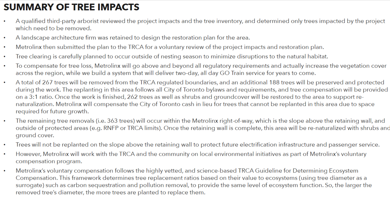

Some political comments:
From Councillor Bradford's website:

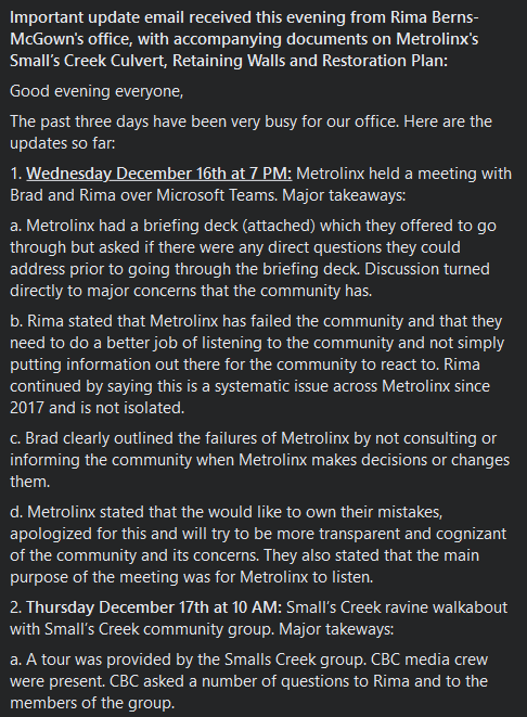

More recent info from the local MPP's office (publicly posted in the applicable FB group)
I have omitted to remainder as it was more advisory than informative.

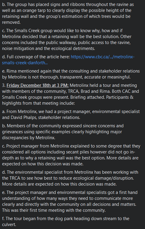

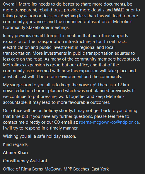

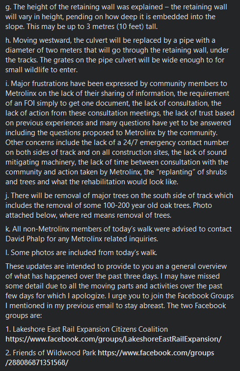

Friday C — The answer is cost and ease of construction. No one wants to bring a drill rig out there to install secant piles.
What other options are there? Not installing the 4th track?

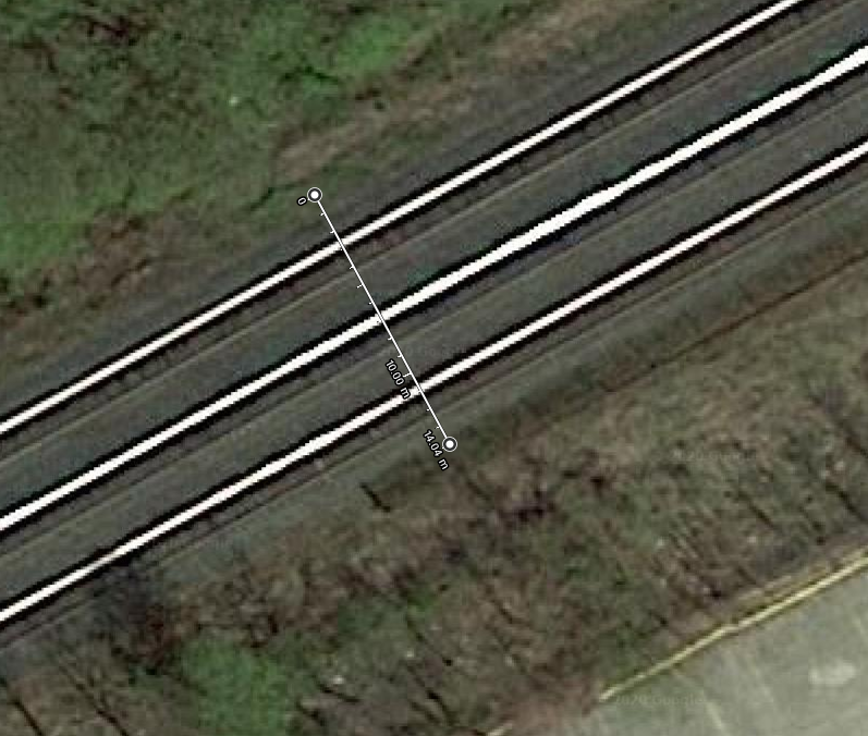

Quick question here for those more familiar w/railway construction practice than I;
Looking at the Small's Creek cross-section, the existing ballasted area is ~14M; if it comes up short its by a small amount, on fairly level ground, to the naked eye.
14M should be, to my understanding, what's required for 4 tracks.
So why does the scale of the intrusion/expansion seem so large relative to the space required?
Do they need extra room just for the noise barriers? I'm just curious, as it seems a bit odd to me.
@smallspy , @crs1026
