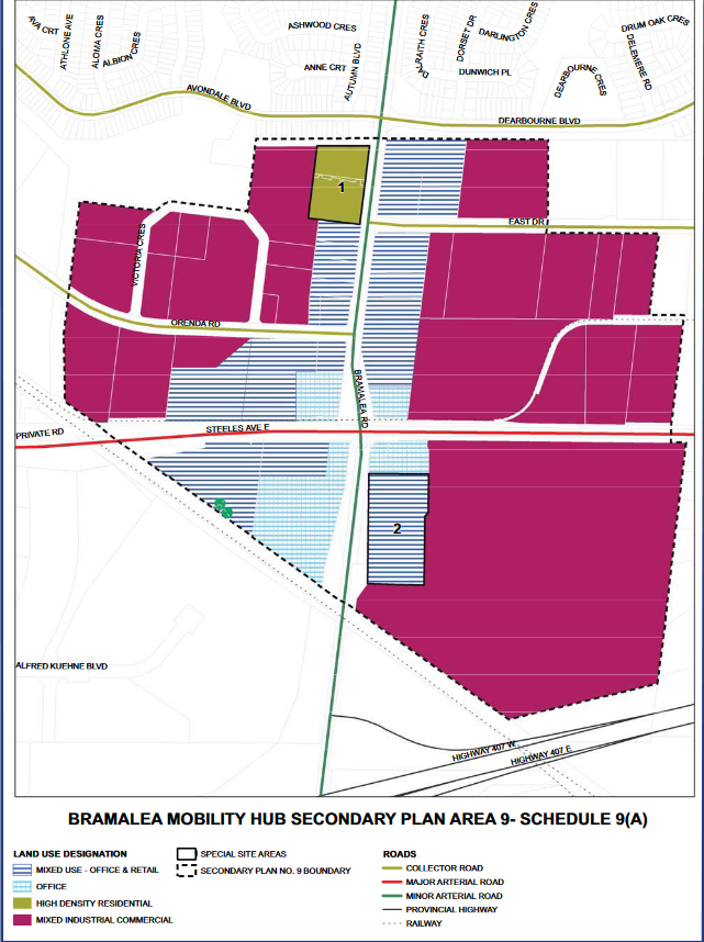

So, to start with, last year the City of Brampton began a process to amend the Official Plan regarding Bramalea GO, however, it has not yet made it into the Secondary Plan.
The Corporation of the City of Brampton does intend the area to be mixed use, but of a retail.commercial mixture, and where mixed industrial commercial would be permitted to the east and west as buffers.

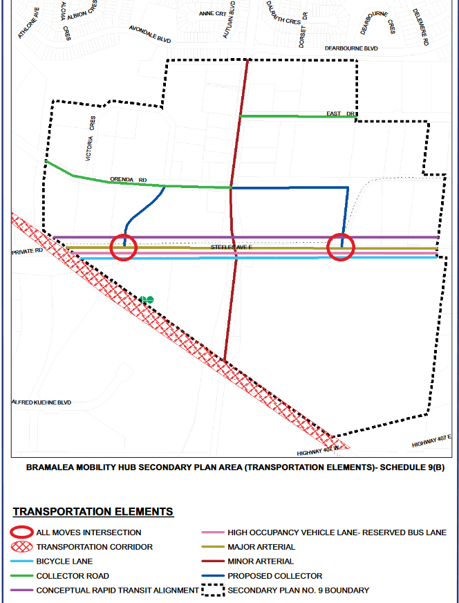

Here is the conceptual road network, it appears this section of Steeles would get a separated bike lane, because only someone mad as a hatter would deem it sane to have bikes share a road with significant quantities of freight.

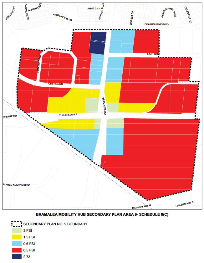

As you can see, either the Corporation is unable to kick the dreadful habit of urban sprawl, or the Corporation is deliberately putting the FSI this low, in order to be able to extort Section 37 benefits from developers. Municipal corporations are one of the few places where extortion and racketeering are not only not criminal, but publicly acceptable.
For those who desire to peruse the consultant's land use study report, that can be found at this link, page 70 of the pdf, beginning at 7.2-9 of the overall city agenda

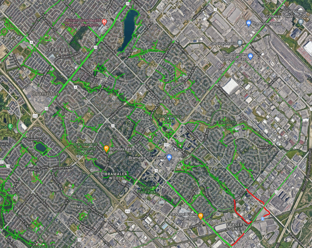

Theres lots of residential connector trails nearby. The type that go between cul-de-sacs and winding residential streets to try and simplify walking/biking through the area. Id say doing some fully separated cycle paths connecting to these would help with the last mile of getting from this area to Bramalea GO.
Green= existing. Red= addition.
Theres already some along Steeles-ish.. but they could definitely be improved

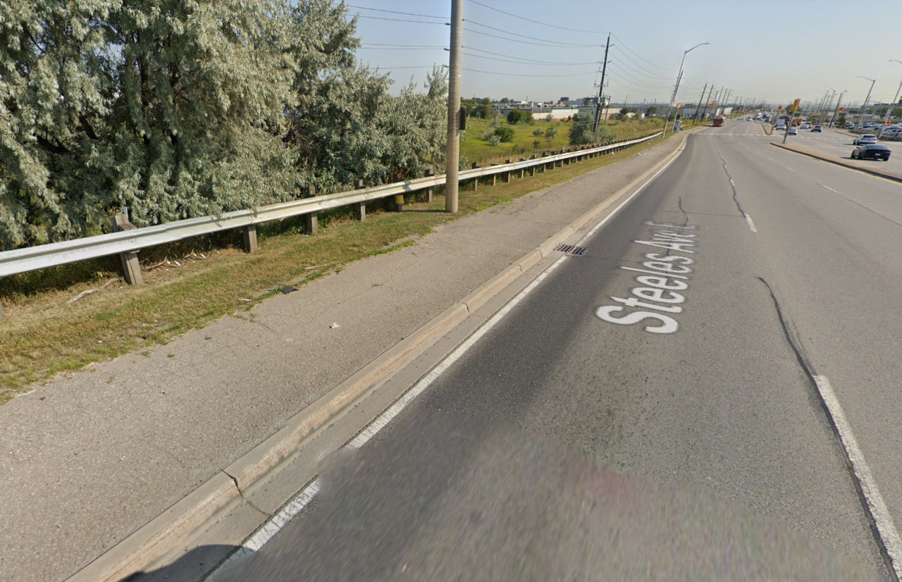

^ While those could be used as bike paths, I don't think they are intended as such. The city calls them splash strips... I think the are intended to reduce erosion from road splashed?
For the bike paths, the residential paths are good, they are often made deliberately circuitous for recreational interest. Wayfinding can be better. I find I have to check my google maps on my phone to not get turned around.

Yes you are right I see them along major suburban roads often, and sometimes they get very skinny suddenly. However google maps identifies them as bike paths, but I think it just aggregates user data (sees many people biking beside the road, must be a bike path) They could be upgraded to be as such.
And while youre right, the residential paths in this area happen to be relatively straight, level and useful from my limited use of them. I know thats not always the case but its the exception here.
