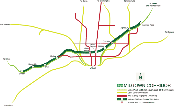

If the full missing link was utilized, including moving CP, the Midtown Line would be a good investment in my opinion, as well as a line from Bolton utilizing the Midtown. The portion of the CP bolton corridor would be fully available to Steeles, and then you could do peak service to Bolton in negotiation with CP.
However it would terminate at Markham before the CP yard, not continue to Peterborough.

So getting away from the conversation about what's likely the full list of potential lines really is:
  • CP Crosstown core section to Markham/McCowan
    • makes a lot of sense once, and it is if, not when, the missing link is in place
    • seems more amenable to a DMU than conventional GO service
